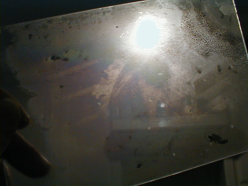

This is an utter swine to photograph well but it's actually quite detailed. I think I overexposed this one. I made a nice enlarged positive from this picture http://www.flickr.com/photos/fishies_go_pook/502375777/in/set-72157600504224851/
and using Howard Efner's post on the Bostick & Sullivan forums, I used about 1 gram of violin rosin (student grade £1.99) and dissolved it in 100ml Methylated Spirit (purple, bought from ironmongers for £2.39). I used about 2ml poured onto a clean, dry piece of 4x6inch glass (from a clip frame, surprisingly nice milled edges too! 4pack of clip frames £1.99) and let it dry overnight. Then I put my enlarged positive on top of the plate with some mylar (from some christmas packaging a few years ago)between the positive and the plate to help prevent sticking (and it did get sticky/tacky). Put it under my philips facial tanner for 5.5 hours, took it out, noticed there was a bit of a ghost image on it. Made a little "fume box" out of a tupperware-type box, some bits of cardboard tubing as plate supports and a glass ashtray of white spirit in the middle of the 4 plate supports. Developed it for about 20minutes, although i didn't see much change after 5 minutes.
It just looks like a piece of frosted glass if it's sitting on a table but once you pick it up and hold it up to the light, it's amazing. The rosin particles scatter the light so if you hold it right up to a light, you get a shimmery rainbow effect (and a negative image. to view the positive image you hold the plate at an angle and have a dark-ish background to view it through).
This is a really simple, albeit a bit long on the exposure times, process and there really should be more people out there playing with this! The materials are so readily available especially if you're as lucky as me and have a musical instrument shop within walking distance. There's a few things I want to fiddle with... I think I have slightly too much rosin in my mixture because my scales can't accurately weigh 1g, I need to learn how to coat plates a bit better, need to try to do less exposure time, etc, but I still have another 3 pieces of glass to do all that with.
Can't tell I'm excited about this stuff, huh? :D

Oh fiddlesticks. I did a perfectly coated plate lastnight to try again, I got everything set up, noticed the mylar I used yesterday had rosin stuck on it, decided to try some plastic from those plastic paper pockets.. well that totally wrinkled up under the very slightly heat produced by the UV light bank and gave an awful orangepeel effect to the plate and ruined it totally. Really really peeved.:mad: I guess i should go out and get some mylar/acetate today when I go to the art store :rolleyes:

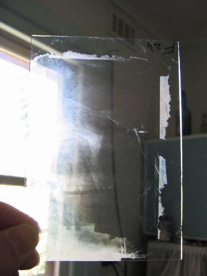

Gee this "modern phsautotype" with rosin is fickle.
today i got what looked like an fairly even coating on a glass plate.
nice and frosty, not too much pooling.
tried a contact print for 1hr, 45 mins in midday cloudy conditions
amb temp 18'c, uv index about 9.
I could see a very faint image, so into the d tank with kero
RATS after only 15 mins the plate had completely cleared, not fair.

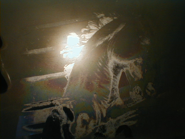

I left my plate(that I exposed yesterday_ over my ashtray of white spirit in its box for several hours and got much better development. Oh well, so what, it takes longer, like the whole exposure for 5 hours under the UV light doesn't take long:rolleyes:
I just added in 30% of water to my rosin+meths mix and coated some plates and they don't seem to be drying much more slowly than without the water but the coating is really really uneven looking to me! I took a comparison photo of a plate I coated before adding water to the solution. I think I might have to just start again with fresh rosin and meths now.

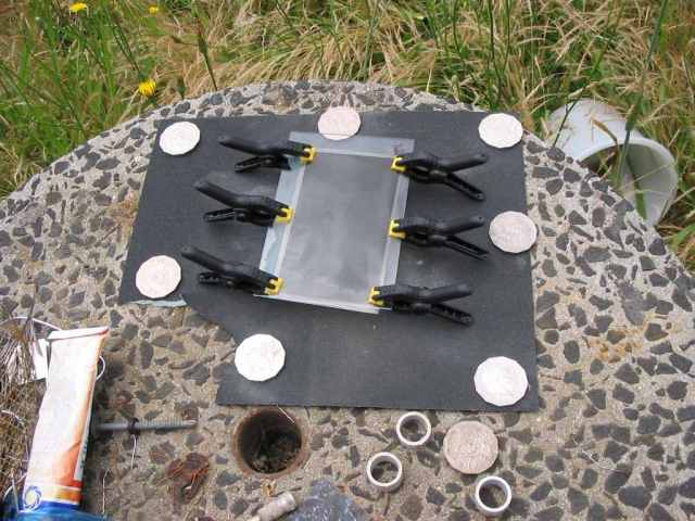

The second experiment was to try another rosin contact print, the rosin coating was not all that even, but I exposed it for 1 hr and 10 minutes.
It was in the D tank for "two minutes" and the coating had almost completely cleared, you can just see a faint image of the two lady's in a wedding dress, its hard to photograph.
I have written up the experiments with more pictures on my website
