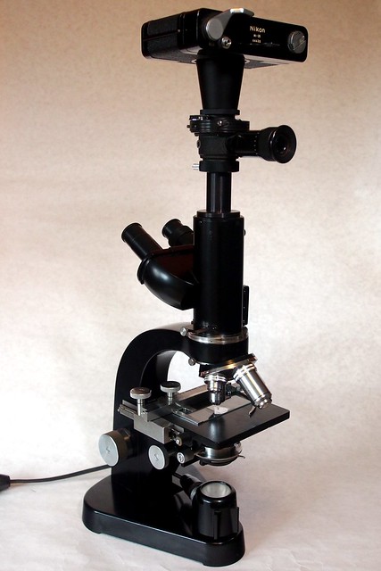

That's a nice setup, I noticed in your Flicker gallery that you have a Bronica attached to your
LeitzSM, nice adapter you made from the body cap.

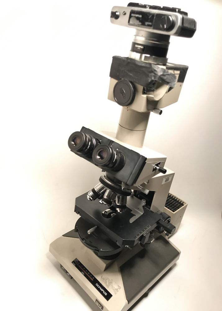

This is the 'beast' I was given -
As you can see the auto exposure body is trashed and has black gaffer tape covering the holes left from
the missing parts.

If you can get the auto exposure working that would be nice, despite how it looks. Maybe some fresh gaffers tape. Nice microscope, is that a phase contrast setup?
I doubt the auto exposure unit will work, from the literature I found online about this BH2 and it's accessories,
the camera has a shutter but it's not used, it's just a cap to protect the film, the actual shutter is in the auto exp unit,
mine is gutted there's nothing in there, hence the previous owners gaff tape cover, I don't think he ever shot anything with it.
I'm not sure, I think it's either a phase contrast or a differential interference attachment, I'd have to look for a
part number on the unit to be sure, it does have swing away filters.

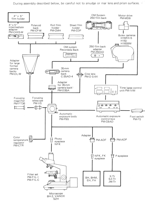

Jim, I used to use a BH2 system to shot microphotography
You need a pm10-ad controller to control the camera part
The full system assemble is shown on the pics

Lasurit,
I just purchased a PM-CBSP unit which luckily comes with the cable for either the PM-10ADS or PM-10AD exposure unit
most of the controller units out there don't come with the connecting cable. now I'm on the hunt for the PM-10xx unit,
seems the gutted one I have is a PM10AK, but from the brochures the 10ADS or the 10AD would work.
I do have some confusion over the PM-10ADS versus the PM-10AD units, other than the former having 1% spot/ 30%
average metering and the latter having 60% average metering, they both have the same specs, is that all that differentiates
the two ?

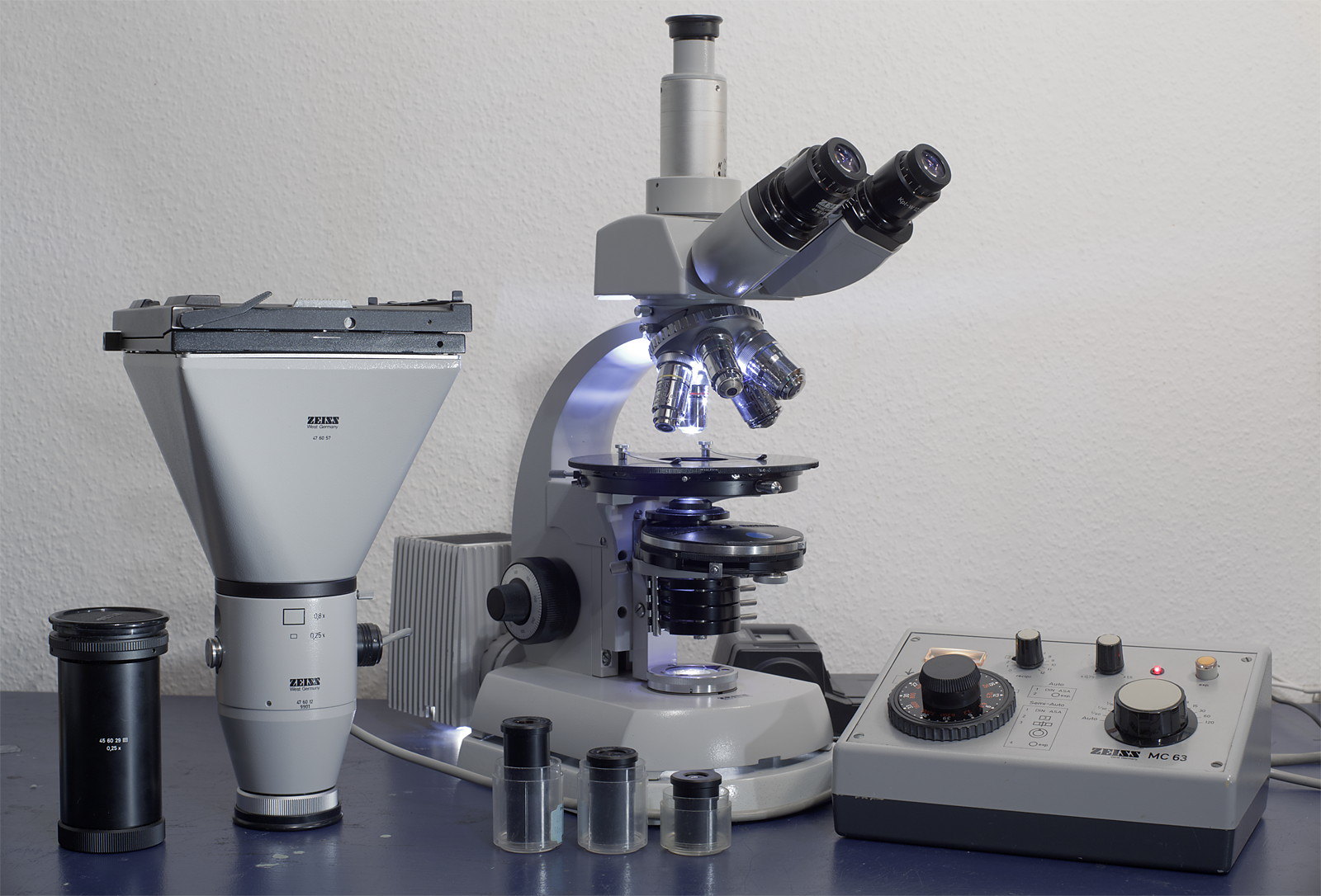

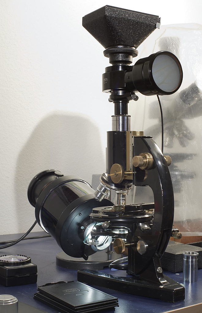

Hi Jim,
oh, yes! I love photomicrography. 😀
Mine is a Zeiss MC 63 microscope camera with up to large format 4x5" set up on a Zeiss Standard 18 microscope.
Some pictures here: https://www.flickr.com/photos/136145166@N02/albums/72157701589192565/
Vintage cameras are fun, too. Like a 1930's Zeiss Miflex I:
more photos: https://www.flickr.com/photos/136145166@N02/albums/72157686135321996/

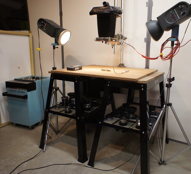

I use lenses down to 12.5mm on my 4x5 -- with or without my Beseler slide copier. No microscope needed. That's micro photography, and Minolta produced the lens with an RMS thread -- same as their 25mm micro.
That's amazing. On my cambo that would give a max magnification of 38x. I have trouble framing my subject at 9x, feels like trying to pick up something tiny while wearing gloves. What kind of solution do you use for focusing at that range? I have a pentax macro focusing rail and it makes a world of difference, but one thing that I liked about my calumet cc-400 that I sold is that it had a knob built in for moving the camera in and out along its axis, kinda miss that sometimes.
Also, would you mind talking a little bit about your lens and shutter setup? The whole world of adapting these wide lenses to 4x5 can get kind of confusing.
These lenses are not "wide" as in "wide-angle". They are short focal length lenses but are specialized for high magnification, and only cover 4x5 at high magnification -- basically microscope lenses with apertures. Minolta was not the only camera company to make them. I don't have one setup. It depends on the subject, the location, and other factors. Sometimes it looks kinda, sorta like this -- not mine -- but the camera is always very close to the subject.
