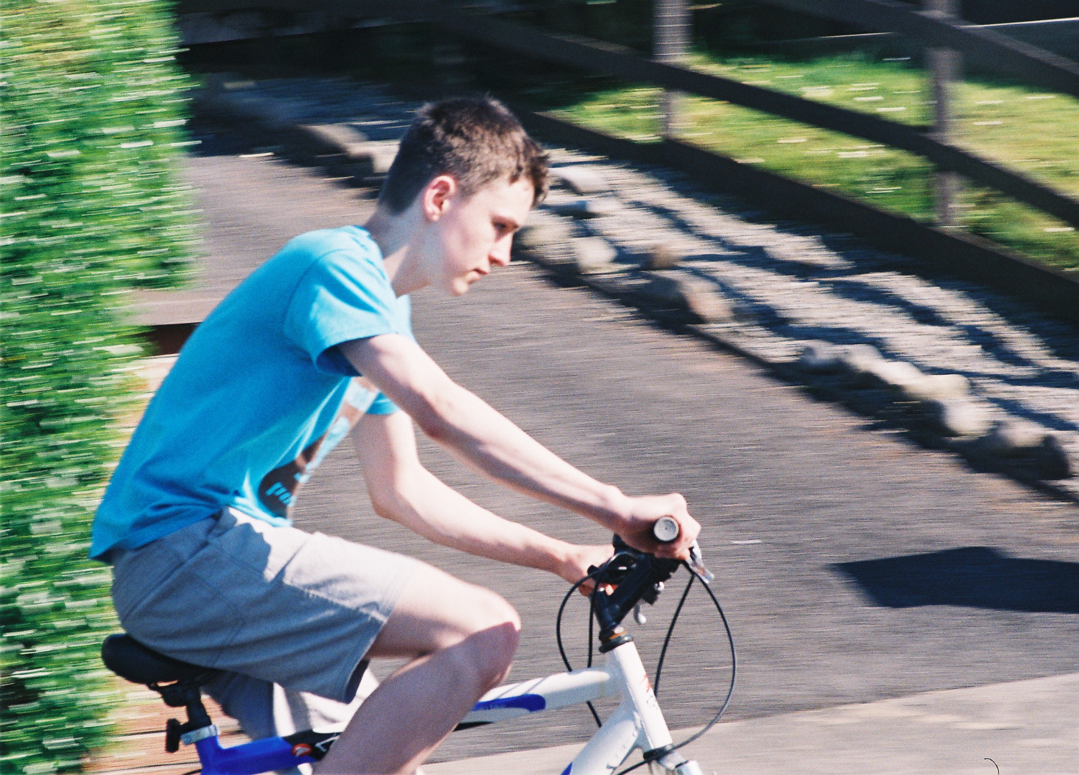

Here is a simple panning test I tried many years ago with my Zenit 11 with a Optomax 135mm f2.8 lens.
The film was Fujicolor C200. I got the blur correct but the subject is a little out of focus. Considering I was shooting at 1/60 sec @ f22 on the Zenit (remember the big mirror slap of the Zenit) I think it turned out ok for a first effort.
I know it's not a runner but hope the sample might help.
