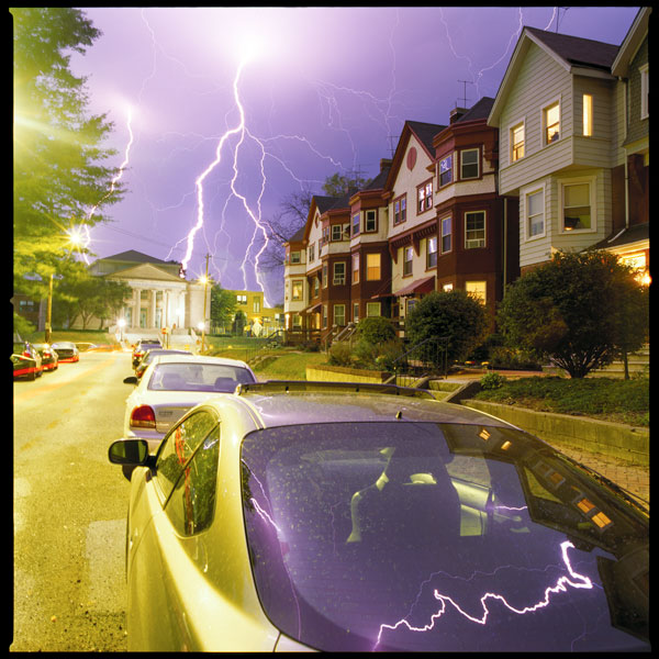

I shot this in 2008 during a freakishly energetic lightning storm. I shot all 12 frames on a roll of 120 Provia 100F, keeping the aperature constant, but using longer exposure times with each subsequent frame. This was the last shot from the roll, a 1 minute exposure at f16. I benefited from street lights for ambient fill in the foreground, but most of the light came from the multiple bolts of lightning that struck within that one minute period.

Great shot Jeff.
