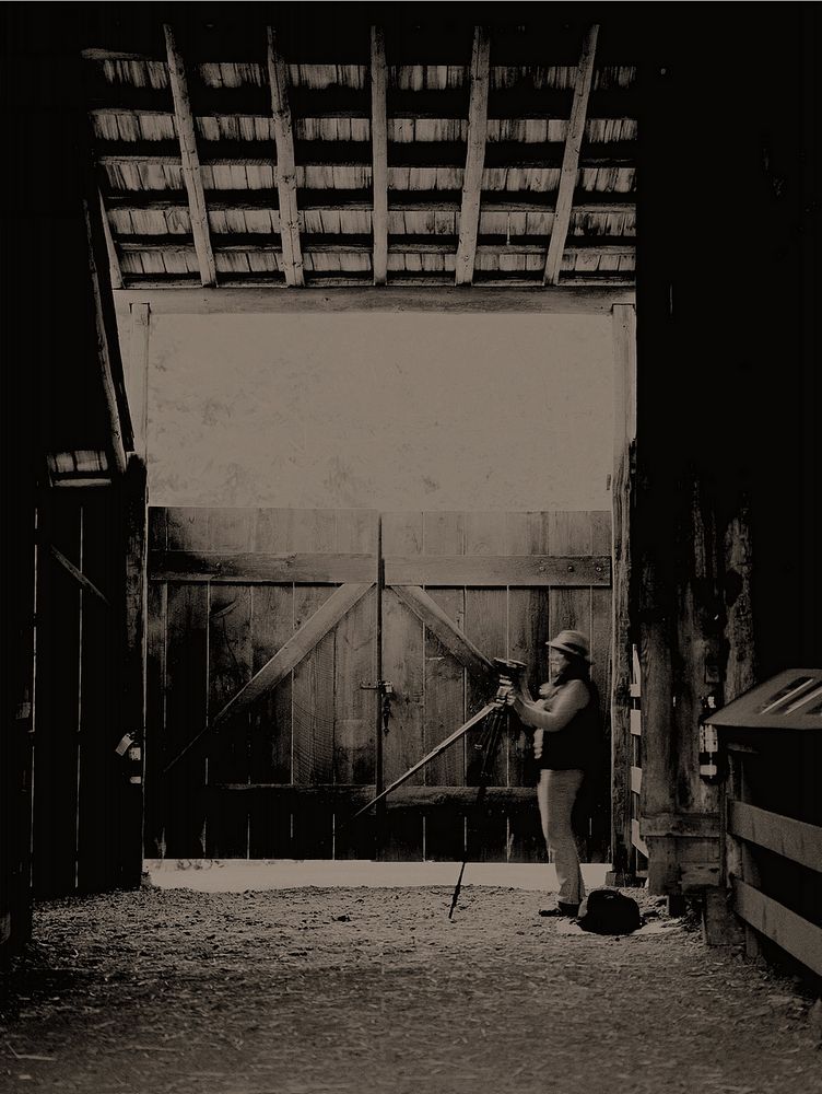

Not a black horse, but a dark photographer:

Very nice image! The dynamic range of this scene must have been huge! Is this a scan of a print? Is it toned?
Thank you Matt. That explains it. I shoot both digital and film often simultaneously so my instinct was to "expose to the right" in both media.
Thanks,
That started out as a B&W negative.
I then scanned that negative, and had an 11"x15" print made on colour RA4 paper from that black and white scan - that allowed me to choose a "chocolate" tone.
I then scanned that print - actually that is a stitched image from two scans.
Then I had to downsize it greatly to show it here.
And yes, the dynamic range was huge. The "blur" is actually subject motion - she is a very energetic photographer!
Fun story: The subject of the photo happens to be a CAPA accredited photography judge, and I knew she was scheduled to come and both make a presentation to the photography club I was then a member of, followed by a critique session for member prints submitted for that purpose. So I made the print for her to critique without warning her ahead of time. When it appeared on the judging stand, she had never seen the photo before, but quickly realized she was critiquing a photo of herself - and she laughed!
