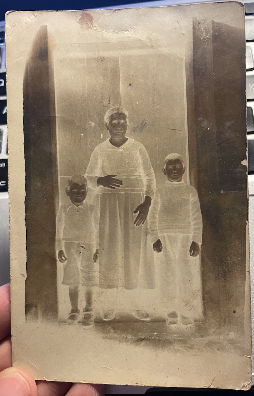

The first, dating to around the 1910s, depicts a grandmother (I presume) with her two grandchildren. It was printed in negative but wasn’t discarded—at most, it was kept within the family, and some scribbles were drawn on the back by children.

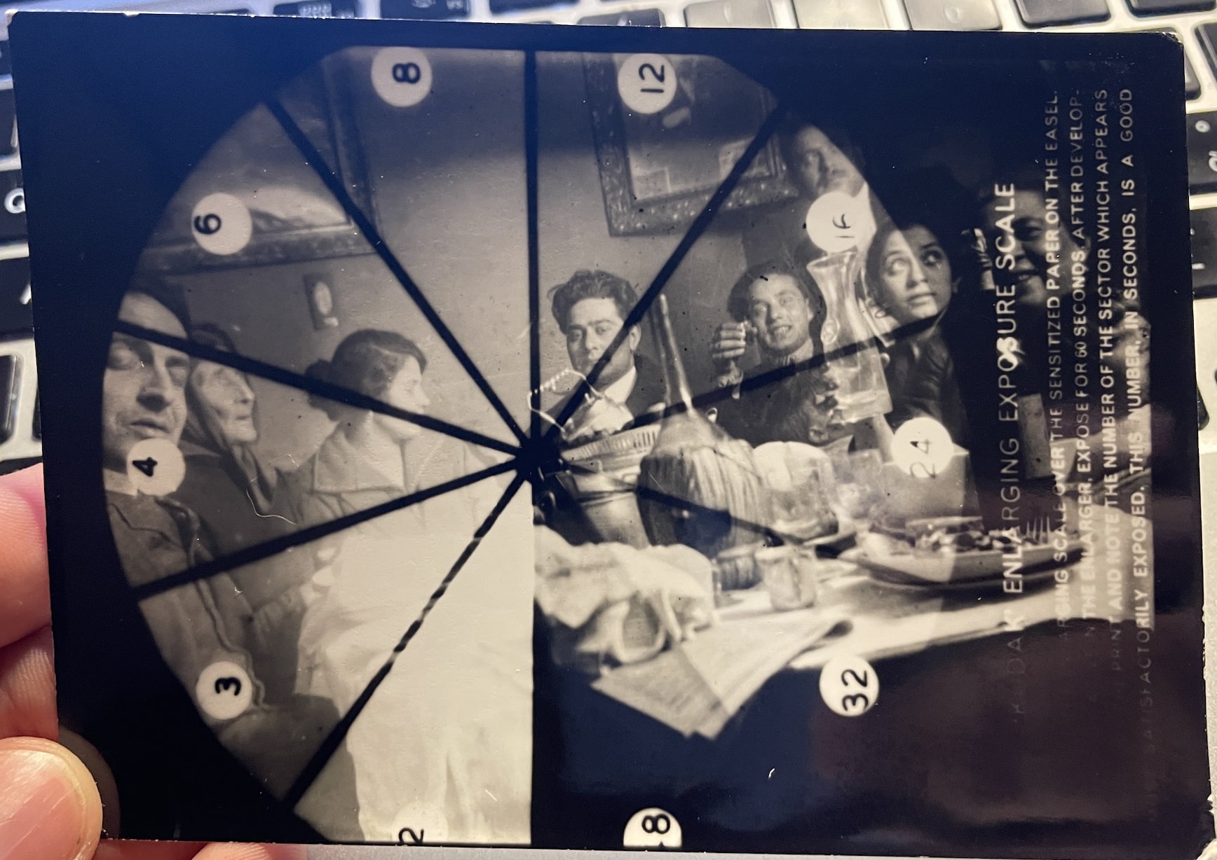

The second, dated between the 1940s and 1950s, shows an Italian family at the dinner table. There’s wine in a fiasco and in the typical Roman one-liter glass carafe, and the grandmother is wearing a veil. But how could the Kodak Enlarging Exposure Scale have ended up appearing in the print?

The second photo

[ ... ] But how could the Kodak Enlarging Exposure Scale have ended up appearing in the print?
Just a curiosity... :smile:
Normally one makes a one minute exposure through the exposure scale and then looks over the results. The numbers would then suggest seconds of exposure. One tends to conclude this was a test print. (Somebody raided dad's darkroom maybe!)
Likely because it wasn't an accident. It may be an in-camera paper negative, and positive prints may have produced from it through contact printing. In any case, printing in negative is certainly not an accident.
#2 as @DWThomas points out is a test print to determine exposure.
I wouldn't qualify either as an error.

That is a test print, made using one of these:
I usually use one of these when I'm working in someone else's darkroom, to help get used to the new environment. Sometimes, if I haven't been printing in my temporary setup home darkroom for an extended period of time, I'll start a session with one.
I usually discard the tests after use, unless I plan on toning prints afterwards, because they are handy for testing toning.
The items you shared are indeed the results of intermediate steps in the process of preparing final prints.

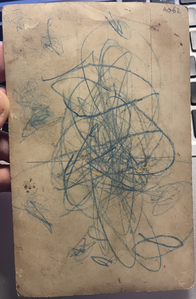

That paper negative has a word on the back, in the centre, under the scribbles, so it wouldn't be great for making a positive. It appears to be a postcard, actually. So, it's not an accident, but it also seems to be useless. I doubt it was made in-camera, since the paper would have been very slow, and those three seem to be relatively without motion (even though they appear to be standing in the sun).
I know of one successful photographer who uses the paper negative to give his prints a more pictorial rendering. He starts from a film negative, though.
This concerned me, too.
It remains puzzling why they chose (as it wasn't an accident, evidently) to print a negative - apparently/maybe even as a final result.
It's conceivable someone did an experiment with a reversal process (optical, by photographing a print, or chemical) and that they chose to use a postcard paper for it. I think Ilford still make theirs (right?) and I suppose it was more common in the past.

Ilford no longer makes postcard paper - although they offer the same paper, the same size, without the writing on the back.
Postcard paper was extremely popular around 100 years ago. It would have been plentiful. So it's not unreasonable someone was messing around and used this piece to try something - maybe an attempt at getting a larger (or smaller) copy of a photo.
On the back, "Ferrania" is written: an Italian photographic brand from the past: https://it.wikipedia.org/wiki/Ferrania_Technologies

Yes, that makes sense. FYI, Ferrania was revived some years ago; they're now again producing B&W film and are apparently on their way (if it ever materializes) towards making a color positive film. They don't make paper currently.

Yes, it's definitely postcard paper. It's conceivable the print was used to make a diapositive by photographic it on a plate of the desired size.
