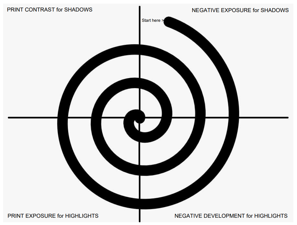

What is this "Photographic Control Spiral" suppose to demonstrate?

I'll guess the spiral is trying to say this:
for (int attempt=0; attempt<3; attempt++) {
neg.exposeForShadows();
neg.devForHighlights();
print.exposeForHighlights();
print.contrastForShadows();
That means it takes three trips to the field and three attempts in the darkroom to get the photo right.

Now we're getting somewhere. Let's say this is the first time we have used this particular film. We used the "box speed" for exposure, so let's use the manufacturers' recommended development time for the developer we are using. After we process the film as recommended, then we can find a print exposure time to get a good highlight. Do you see where I'm headed here?

Thanks for hanging in here. So, we are still learning about the qualities of our new film. We exposed and processed like the manufacturer said. We made a print to get a good highlight, but let's say that over all the print has too little contrast (or too much). These days we can change the printing filter to improve contrast. May not get a perfect print yet but can improve it. By evaluating our best print so far we can decide whether to increase or decrease how the film is rated for our conditions. And so on around the spiral until we have a perfect print.

This way we eventually find out the best speed rating and processing time for the film. No need to test again unless conditions change.

I don't think most of us are connecting your graphic with what you are saying. I appreciate the effort, but the iterative process you reference in the words doesn't seem to match the spiraling graphic.
Perhaps you can explain how the two are connected for you.

Thank you for introducing me to the concept of "iterative process". A process of "trial and error" is what I am trying to describe in this thread. Photographers get use to this idea...I just didn't know the proper term or even understand the precise definition and probably still don't.
The spiral graphic helps me to visualize the process of refining a system of exposure and development and printing to consistently get a print with which I am satisfied. It is certainly an oversimplification considering all the variables involved. The idea is to control important variables until I have a practical technique to get very close to the end result I am working toward, somewhere near the center of the spiral. The method is nonlinear. (Your Adams reference is apropos.)
