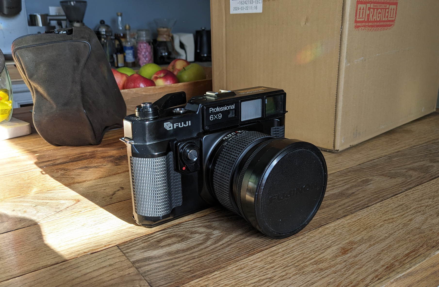

I have been in love with the GW690 series for years and have been patiently waiting for a good deal to come up (and convince the Mrs that I *needed* it of course). I have been to Japan 3 times and have had my eyes open for one in the shops there (and at home too) and came up empty each attempt. Almost pulled the trigger on the GSW680II on the last day of my most recent trip, but really wanted that bigger 6x9 negative and the slightly faster lens of the 690 with the 90mm f3.5. I already splurged on an FD mount 35mm f/2 concave edition that was in beautiful condition and couldn't let get away, so I didn't really have the funds for it anyway.
Fast forward to this year and I come across an immaculate GW690II on Yahoo auctions Japan and pulled the trigger for 66,666¥. Not quite the deal of the century especially when factoring in shipping, but certainly better than eBay. The glass is flawless, the viewfinder and rangefinder patch are super clean and bright, has new light seals and has been cleaned inside and out. You can imagine my excitement when it finally arrived after a couple of weeks and unboxing to try it out. And then to try to fire off a few test shots empty only to find.... that the focus mechanism is completely and absolutely jammed. To quote Tinny Tim from Futurama, "You raised my hopes and dashed them quite expertly, sir. Bravo!"
To say I am displeased with the current situation is a massive understatement. I took it to the local repair tech near me who held on to it for a couple weeks to work through his backlog and then got the call the other day to tell me that it looks to be completely screwed. He doesn't think he can get the lens apart to get to the helicoids and try and clean them up and get some new lubrication without damage to the lens itself.
A shot in the dark, but has anyone else had this issue too? I have no experience trying to even begin disassembling a GW690II so I don't know how difficult it really is trying to get to the focus mechanism in one of these. The shutter speed and aperture rings turn just fine and there is zero evidence of it being dropped or anything like that since there is hardly a mark on it other than some super minor scuffs around the tripod socket and a little tiny bit of wear around the shutter buttons. They're at least letting me return it for a refund (with me still on the hook for shipping), but I'm debating trying to get a second opinion to have it looked at it just because I've come so far and haven't been able to find such a clean example for a decent price in months/years of trying, not to mention I'm sure it will just go right back up for auction for someone else to get scammed on it as well.

Check with CameraWiz - he services a lot of these for local schools:

P.S. This is why I rarely buy from Japan, and when I do, only on eBay with highly rated dealers (>99% positive) and only with full return privileges at their expense.

That is probably what I'm going to end up doing. I've been fighting with the 3rd party forwarding company on refunding the purchase price and the shipping and it looks like they are going to cough up the shipping cost at least for the shipping to me in the US, but have been dragging their feet on committing to covering the return shipping as well. I'm not not too keen to lose $75-100 to ship a broken camera back and get nothing in return so I've been looking around for anyone who has ever had this kind of issue and/or had to disassemble the lens one of these before try and gauge if it is worth a second look by someone else.
I figure I'm still under the threshold of getting another minty one at the going rate on eBay if someone is able to repair it for a decent price, which is why I've been at a crossroads and using the time the forwarding company is giving me trying to figure out if they are going to refund the return shipping to see if it is worth it. Worst case scenario, I get the credit card company involved and they negotiate it with the forwarding company and Yahoo auctions I guess. Just sucks to have this kind of thing work out great for me in the past only to get bitten in the rear when it comes to the biggest sale I've done.
@5BucksAtThriftStore sorry about your ordeal. The best scenario would be to get a full refund including shipping back.
It's likely fixable but you'd have to remove the lens board, separate the lens and shutter from the helicoid, then let naptha seep in the helicoid threads to dissolve whatever is in there. Try to get some other quotes?
