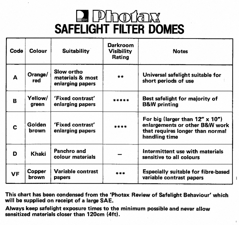

While in my darkroom yesterday evening I found the box one of my VF domes came in with this sheet:
While Kodak and Ilford as well as Paterson/Photoax make loosely equivalent safelight filters they aren't exact equivalents. I bought a third Paterson/photax safelight at a cCAmera Fair last year for ÂŁ1 it has the C filter dome which is equivalent to a Wratten OC, it's brighter so less safe than the VF.
I've used my VF filters with various Foma papers with no issues at all however as pointed out this one needs a different safelight, Photax sold the D Khaki dome equivalent to an Ilford 908/Wratten 10 but while this would be very safe also very dim and probably impossible to find. That's why I suggested using the E14 LED Pygmy Bulb, 1.4W Red in your existing safelight with the VF filter,, it's a direct fit.
