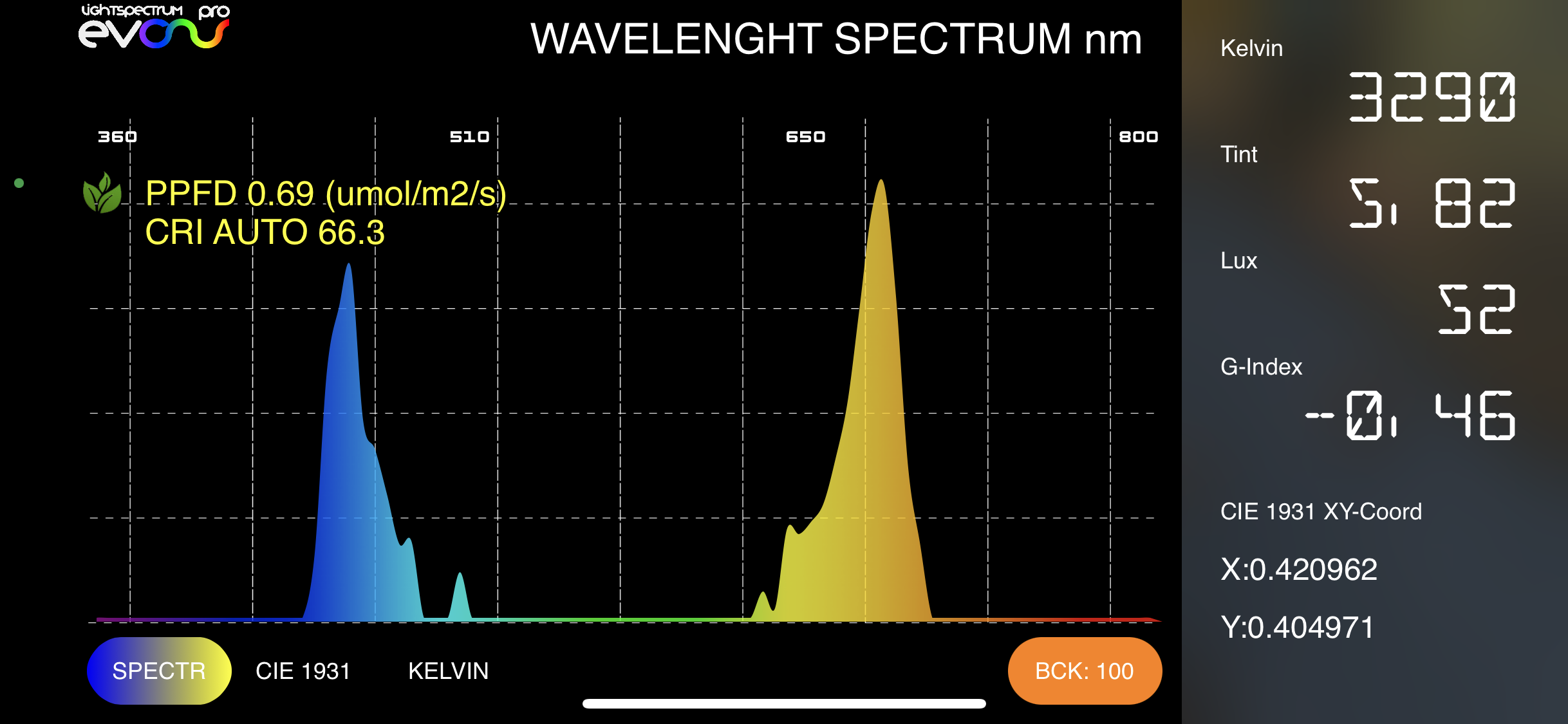

Thanks, that is fun. I had expected to see a spectrum like that in the phone app, with each MG filter narrowing it down to a different band. I wonder what the app is doing then?
The app is faking it. The camera has only three broadband detectors (times many pixels) for RGB. So I'm 99% sure the app is faking it, unless the phone has a spectrophotometer.
Suggested experiment: show your iphone app a CFL or a "neutral white" LED
and see what it tell you.
Moreover, the spectrum of light on the easel when using a MG filter actually consists of two distinct (esp. for hard grades) peaks: one, a balance of blue and green, for the paper, and the other, red, so that you have something to see on the easel when the ref filter under the ens is engaged. his cannot possibly be described as a single peak.
Yep. Well, granted, it's very well possible most smartphones actually use a separate/dedicated color temperature sensor, but the low-end sensors you'll find in a typical phone would also be 3-channel sensors, so the argument still stands...

Looks like you are absolutely right. This is what it showed me with a neutral white LED bulb. I had to point the phone slightly away from the light to make the blue peak appear at all, and that may reflect our blue kitchen cabinets!
