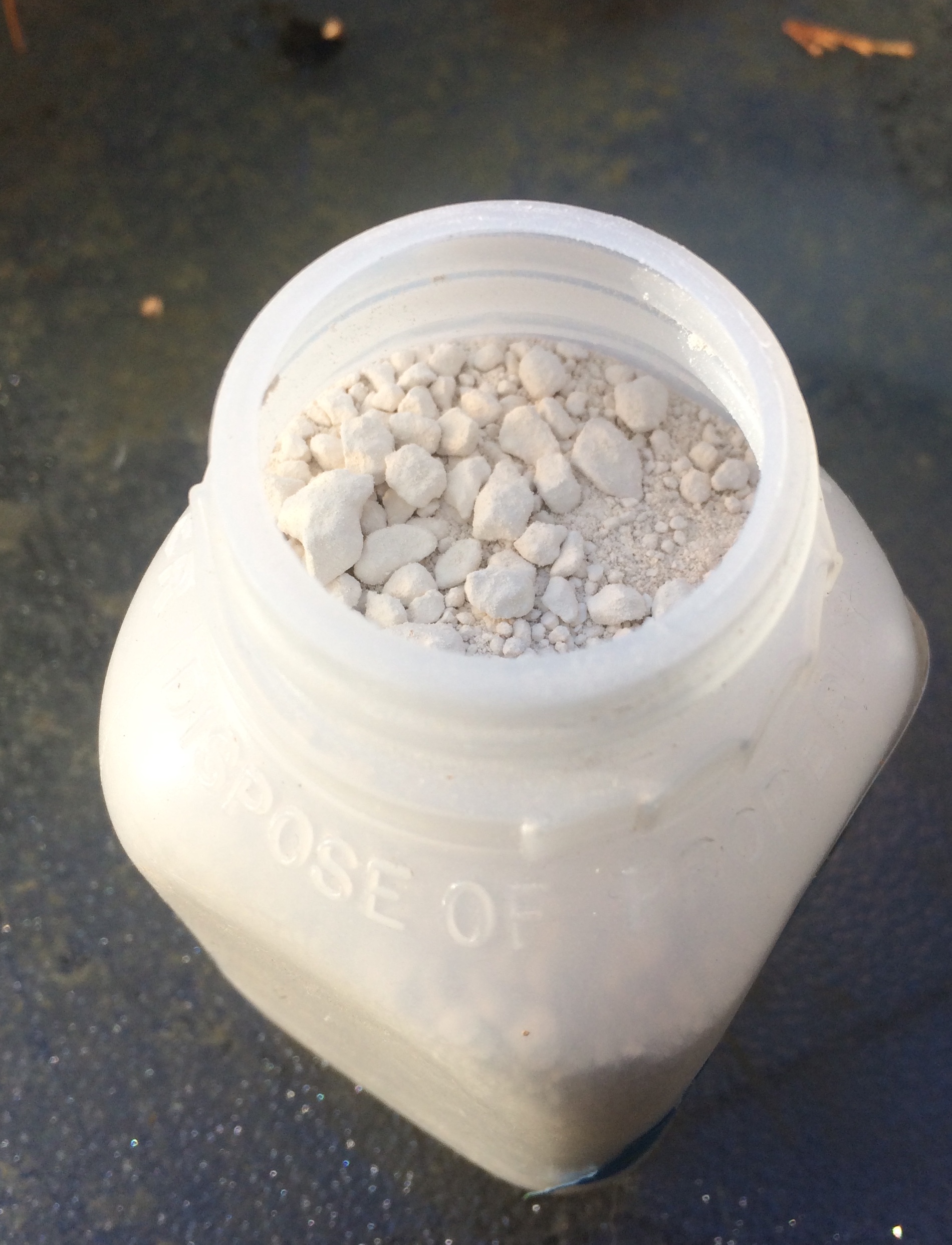

@bluechromis What colour was your phenidone?
It is just a bit off-white buff color.
It seems like a slightly off-white buff color
