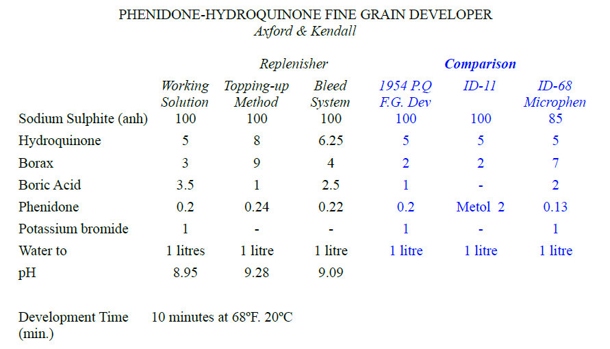

I would think Autophen is slightly better than ID-68/Microphen, Ilford research realised the PQ version of ID-11/D76 gave a slight speed increase over the MQ developer and took this a step further by cutting the Sulphite for ID-68/Microphen, they also dropped the Phenidone from 0.2g/l to 0.13 g/l so requiring an increase in development times.
In Kendall's 1940 Phenidone Patent there's an Example of a PQ version of ID-11/D76 just substituting the 2/l Metol with 0.2g/l Phenidone, but with no changes in buffering, By 1954 which is around the time of Phenidone's commercial introduction by Ilford. In the next few years there's some slight tweaking of the buffering until the final published Autophen formula and its introduction in 1957.
As you can see from the above image Autophen was not sold in "Amateur" sized packaging, and was available in Powder as well as Liquid form.
