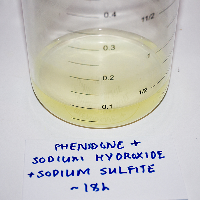

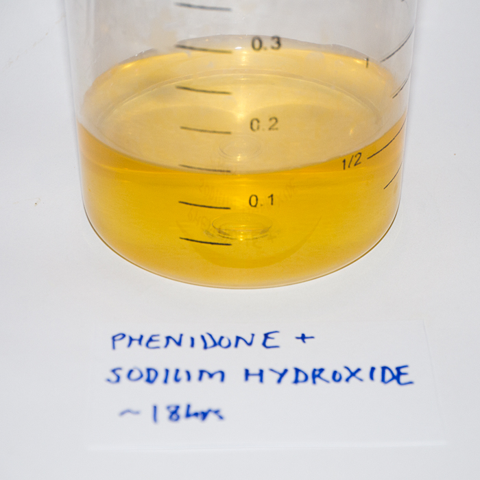

In my experiment with phenidone +sodium hydroxide the green color only appears if sodium sulfite is also added, see the result after ~18hrs in an open container.
Without sulfite it goes yellow.
