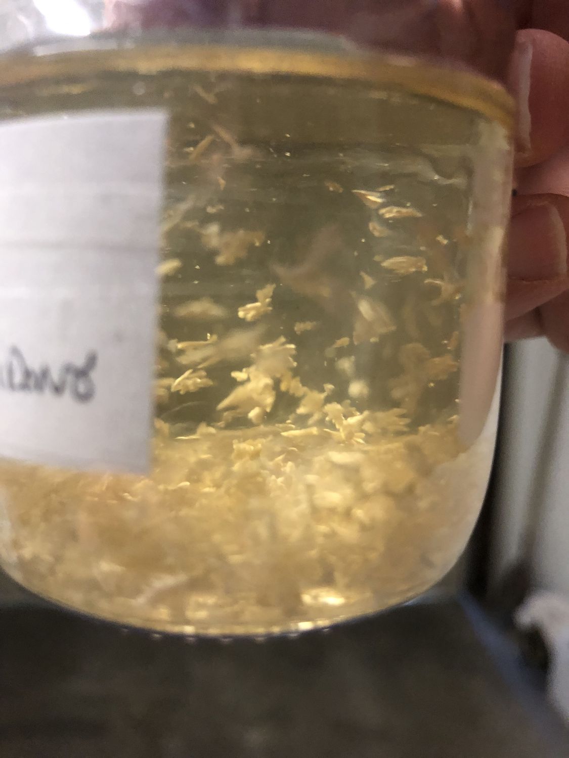

I wasn’t anywhere near saturation, it was a 1% solution iirc. It was completely dissolved and clear, room temperature was about 20 Celsius, give or take.
I didn’t have any troubles dissolving it, but after a few days (at room temperature) I get some deposit that dissolves when reheated.
Quick question: Where have you ordered your Phenidone that falls out of solution?
What colour is the solution and the residue?
i ordered it to a polish chemical distributor from Polan i found on Etsy. The powder is just a tad off-white, very slightly brown. The solution is a pale yellow, flakes are whitish.
Very bad picture of it below:
This weekend i made another solution with a pharma-grade glycol and phenidone from Bellini, solution is crystal clear. I'll report later on how it goes...

I had bad experiences with Phenidone from Poland.
The phenidone I've had so far is either tiny white flakes or a very fine, *very* pale creme/yellow-colored powder. Brown is odd.
yeah, maybe brown isn't the right choice. I'd say a very light beige, probably one of the first shades of brown but still with a yellowish hue.
As they say, men only can recognize two or three colors...
I want to point you to this:
mine was another seller (or, at least, supposedly with a different name and from another city).
We had bad luck with 2 sellers from Poland as pointed out in the thread.
All came out of the same imported source and was distributed by the sellers.
I'd advise you to look for a different trusted seller (like Phototechnik Suvatlar)
i only read the first post, now i'm reading about synthetika. They were my source, so yeah.
as i said my new phenidone comes from fotomatica.it, which resells Bellini raw chemicals. I think this is one of the most trusted sources available today. Suvlatar also i a great source, but from this seller i can buy other stuff and have lower shipping fees.
Ok, my solution is similar to the third one in this post, but with less flakes.
Anyway, this phenidone suspicion came because i mixed some pyrocat with this phenidone (and catechol coming from the same shop), and it kinda worked. But i didn't have any experiences with pyrocat, so who knows.
After some time i mixed some ID-78: image on paper started to appear within a minute (!), and never fully developed, let's say that after 5 minutes in the bath results were like 20 seconds in D-72. My hydroquinone (some from this shop, some not) is fine because i usually develop film with D-76 that gives credible results, so i put it all together and began thinking there could be something wrong with this chemical...
