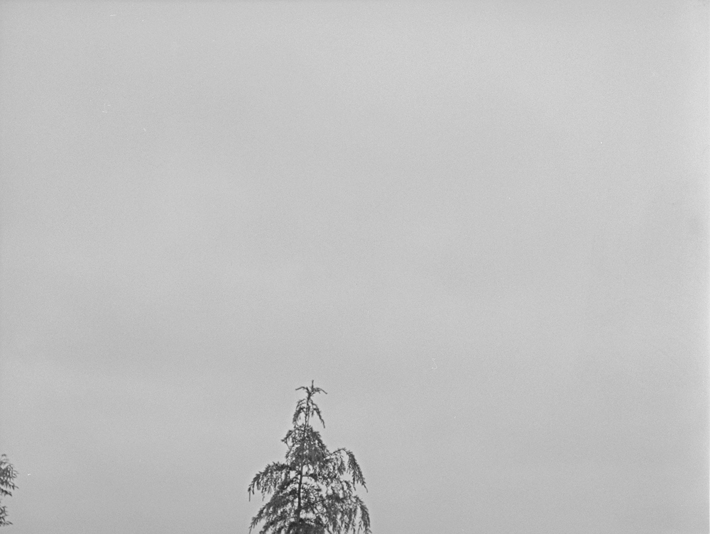

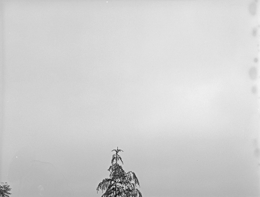

Here is the result of a minimal agitation test with 120 film.
First,IMO for 120 film minimal agitation,stainless steel reels are better than plastic Paterson System 4 reels (which I used for this test as I have 3)as they are less prone to airbells and streaking.Better results than here should be possible.
I took 645 photograps on FP4 EI 64,a general view including the ground then shots of the sky with the same exposure.Repeated this on a second roll.Both rolls were given a 2 min presoak and developed:
(1) Pyrocat HD 1:1:100 minimal agitation 18 min 70F Agitate 1 min then 10s every 3 min.
(2) PGK 005 1:1:50 minimal agitation 24 min 70F Agitate 1 min then 10s every 3 min.
The tanks were rapped on the bench after agitation to try to dislodge air bubbles.
In printing ,corrections were made to give a good print from the general view neg.A typical sky neg was then given the same correction but darkened to simulate burning in.This shows up any unevenness.
Most of the Pyrocat HD negs were nearly perfect (a few show marks near the edge) but it is just possible to make out a lighter line at the right hand side ,which corresponds to the part of the negative near the top of the reel.(left attachment).
Most of the PGK 005 negs show blotches (two were nearly perfect).These again are on parts of the neg near the top of the reel.(right attachment)
Whatever the cause of the blotches,Pyrocat HD seems better at avoiding them with minimal agitation.

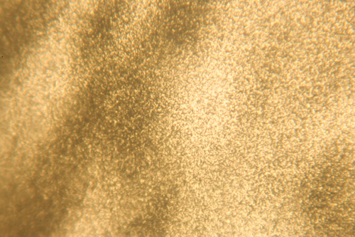

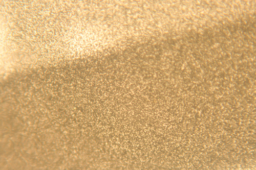

I made a couple of photomicrographs to compare the grain of APX 100 with my PGK pyro 005 and Pyrocat HD. They are of pieces of negative about 0.2 mm across.Not a lot in it at first sight.

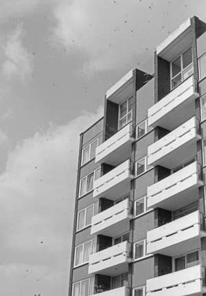

The TEA version of PGK Pyro,given below,has no K. It is much more active than my previous PGK 005 and I used it with the times for PMK Pyro diluting 1:100.
However, it has a serious problem with uneven development.
Agitating at 15s intervals I obtained underdeveloped spots on the negative.Continuous agitation with another manufacturers film produced the spots shown in the attachment.
I am inclined to return to the water based type of PGK pyro.
