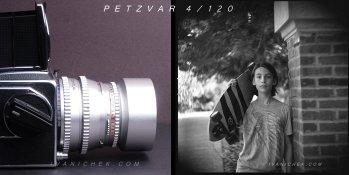

Hello!
I'm going to launch my second Kickstarter project. This time I hope to fund the creation of the 2nd generation Petzvar lens - the Petzvar 4/120, which incorporates a leaf shutter and is being made specifically for Hasselblad 500 series cameras.
As it's still a standard Hasselblad V-mount, the 2nd generation Petzvar can still be mounted and used on 200 and 2000 series bodies.
Also, I will add two more mounts: Pentax 645 and Mamiya 645.
I will appreciate your support or feedback.
The project has been approved by Kickstarter and will be launched within a couple of days. Here is the link to preview page:
