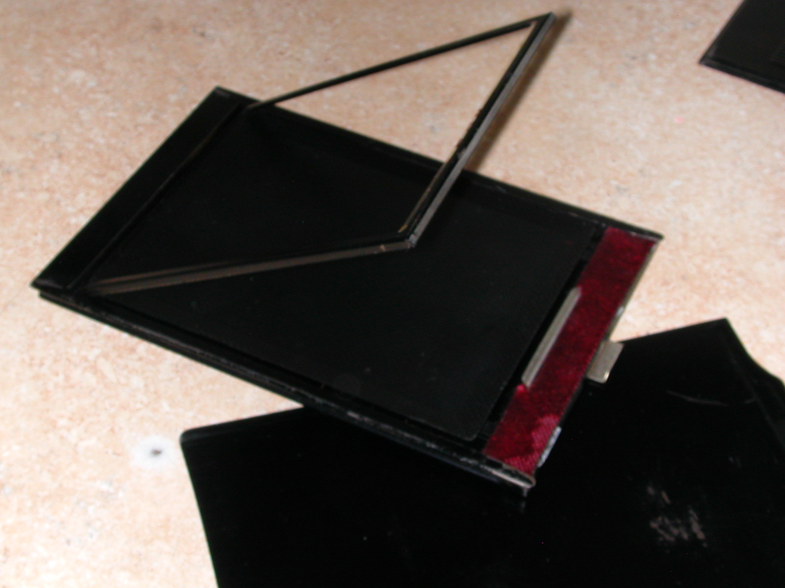

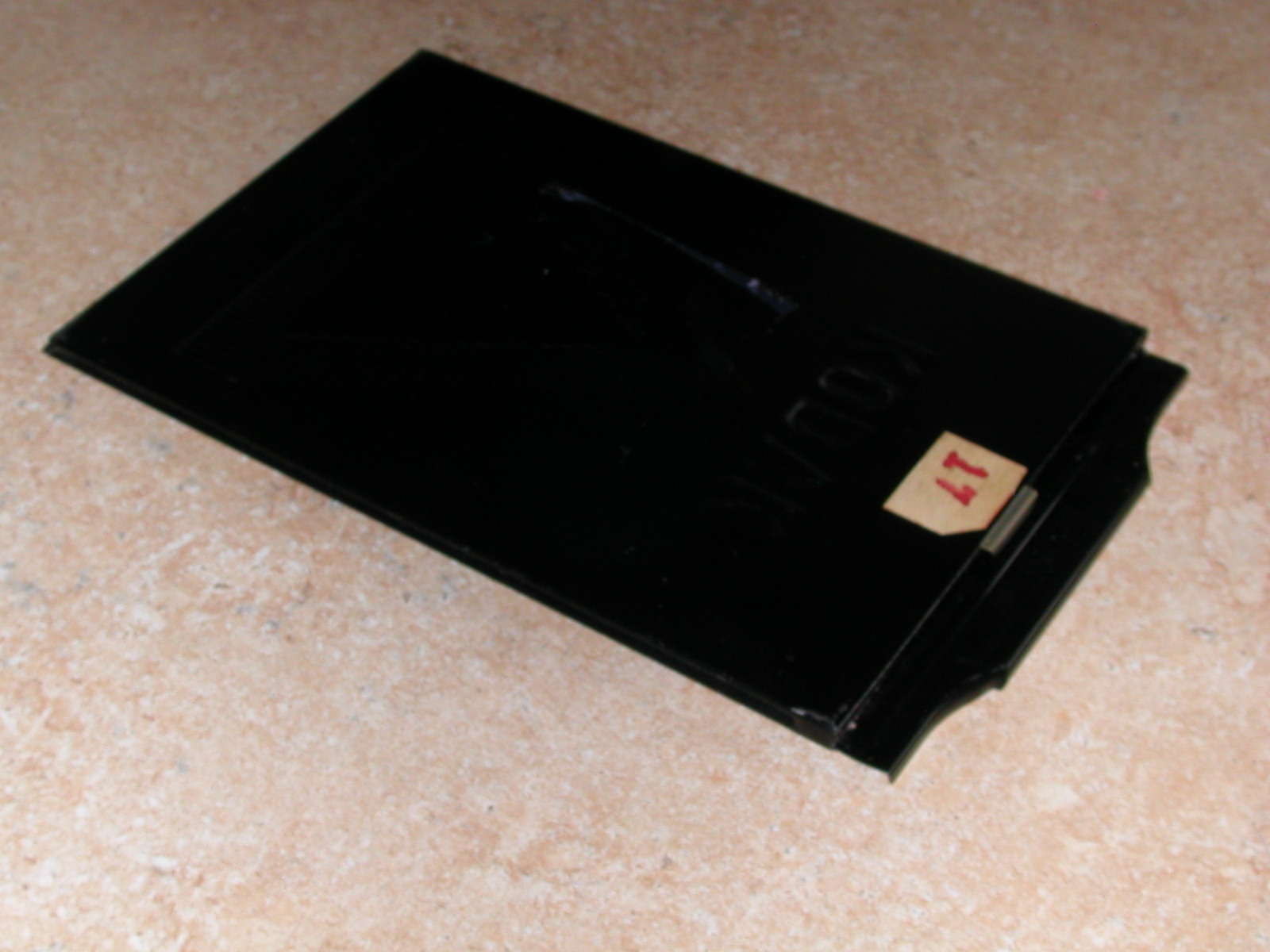

Have 7 or 8 of these 9x12 film holders, There is a flat spring plate that presses against the surrounding 'film' gate that holds it flat.
Will these also take the Dry Plates?

From what I can see of the pics, it looks like they will.

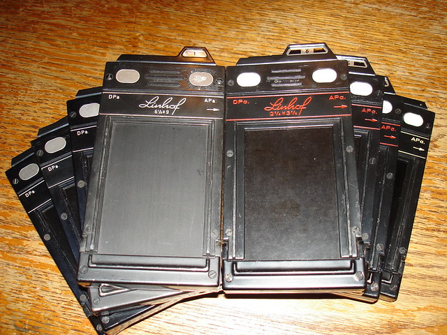

Jason and others asked: Who makes Universal holders for glass dry plates?
2016-01-16 13.07.45 by Nokton48, on Flickr
I have some of these Linhof ones, they are great. Will work for film or dry plates. They are double sided, so two dry plates per holder. Built to Linhof quality standards. These are sized: 6.5x9cm, and 2.25"x3.25". I also have quite a few in 4x5" and 9x12cm.
