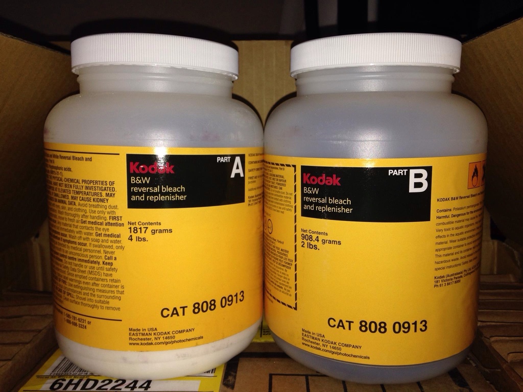

Gerald, do you suggest Ilford's recipe even for the Kodak permanganate (Parts A and B) that I'm using?
My advice was mainly to those who like to "tinker" with formulas. Permanganate bleaches are one instance where the manufacturers recipe be followed carefully.
The main problem with permanganate bleaches is the possibility of emulsion softening. Copper bleaches have the same problem.
I don't know which Kodak bleach you are referring to. Kodak uses R-10, a dichromate bleach, for Tri-X reversal.
This stuff. Permanganate.
Permanganate
