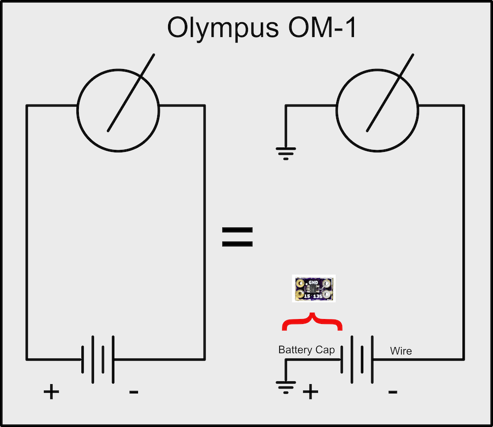

Ah, I see the problem. Yeah, you'd either have to hack the battery holder or at least fashion so.ethkng that fits inside the battery compartment, or use a voltage drop approach that will go on the negative side of the circuit.

One option would be to tap into where the meter circuit contacts the chassis, but that is up on top where there is not much room. Too bad because there is a lot of extra room where the wire comes off the battery holder at the base of the camera.

OM-1?
MattKing
Apr 24, 2005
55,452
Delta, BC Canada
Yes, the chassis or all the metal structures of the OM-1 are positive.

Can’t you use the on-off switch? Haven’t tried OM-1 yet so I don’t know. If not I would add a switch for the regulator and mechanically link it to the on-off switch. Maybe a reed switch and a magnet if you can’t get in there.
