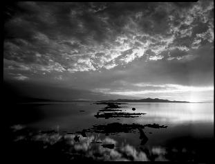

Grain is a function of films structure, speed and development. It is possible to have apparent grain or no apparent grain depending on the choices you make. Polarizers deepen blue sky when at right angles to the sun. Red, orange, and yellow filters block blue and therefore darken skies. The more blue blocked the darker the sky and greater the contrast against clouds. Red blocks the most blue. Most serious landscape people shooting film aren't using 35mm for various reasons, so what you see in general for 35mm landscape isn't so much a limitation of the format but rather the limitation of the average practitioner, however careful searching will find those who are the shizzle with 35. Salgado and his printer for one. Left is an 8x10 by me, but it just as soon could have been 35mm, with the film, exposure, and development I used, a 35mm neg could have been enlarged to about 11x14 quite satisfactorily. The one on the right is Salgado.

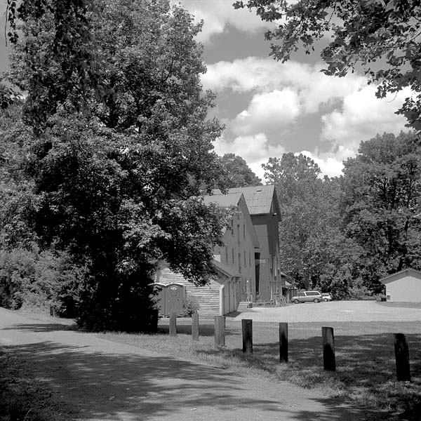

I'm still unclear on the original question. The original looks to me like a less-than-good scan of stormy clouds in B&W vs a digi-shot of a crisp, clear sunny scene that suggests some tweaking. But it is also important to realize that in sky shots, atmospheric haze can pretty well make or break the results.
Here's a medium format image on Acros 100 with no filter, but looking away from the sun on a fairly "crisp" sunny day.
Note too there is little shadow detail at the bottom of the near big tree, the exposure here is somewhat optimized for the sky. There are a large number of variables, regardless of the medium.
