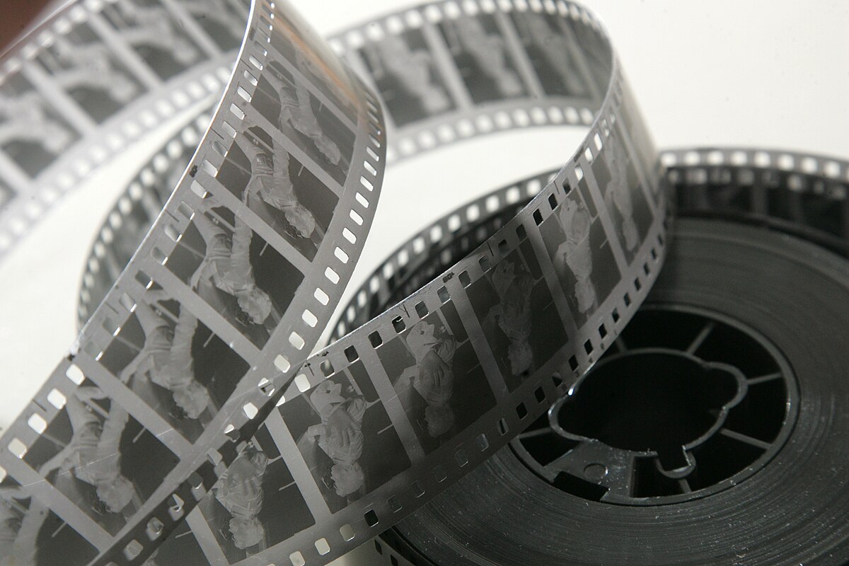

At my Darkroom Group meeting yesterday my friend who has the Pentax 17 was making some work prints from his negatives, in advance of creating some diptychs for Exhibition prints.
They looked really good, and really surprised my other friend at the meeting, who hadn't really appreciated before the capabilities of half frame.
So we doubled down, and described what standard fare movie theatre films used to consist of - vast numbers of half frame images, each blown up to fill the big screen! :smile:
Actually Not even Half Frame, when sound came out they made room for the sound track and shrunk the Standard image, then with Wide screen that streched it vertically.
only in the Silent days were movies "Half Frame. that Wikipedia link points to the section that explains "academy Format" and some of the dimensions that came later.
