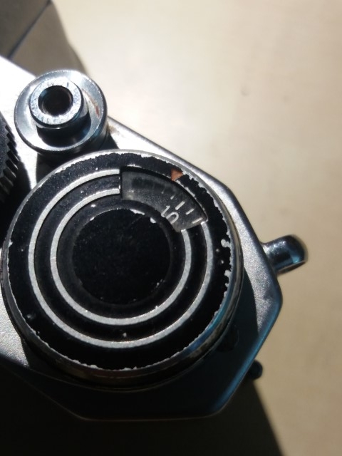

What ho one and all,
Starting a learning process with old camera restoration and as such, purchased a non-working Pentax S1a.
Viewed some YouTube videos and by some cleaning with isopropyl alcohol the application of a bit of sewing machine oil, it is working again.

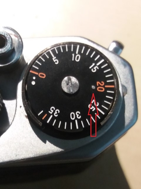

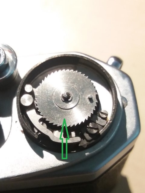

However, in the process, I removed the top, including the wind lever, to lubricate the bits and bobs below and since reassembling, the frame counter does not rest to zero.
When I dismantled, the pin (red in photo two) reset to around the 6 o'clock position which displays zero in the window. Now it stops at around 3 o'clock (green arrow). It does count up, and resets, but not where it should.
I only removed the top plate, nothing below so don't know what I have disturbed.
It is not big deal as this is a learning experience but would be nice to know.
As an aside and part of the 'learning' experience, had difficulty removing the screw in the middle of the frame counter. Applied a bit of omph, and sheared the head off. Vidoes of similar cameras showed that it undoes clockwise. The lesson, do not apply too much torque and try the other direction!
