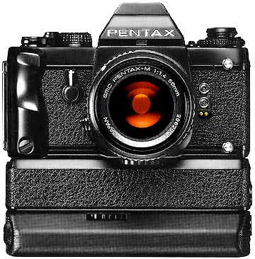

The same is on a LX in unused condition wich looks like this here :
But this LX (unused) is also rare and still expensive! The produced LX before 1990 are too old -
remember its age > 28 years. A service to change a couple of parts is allways necessary!
( Mirror dampers).
Conclusion : Electronic failures with used LX is possible but much more possible is incorect shutter speed with professional used cameras due to mechanical wear.

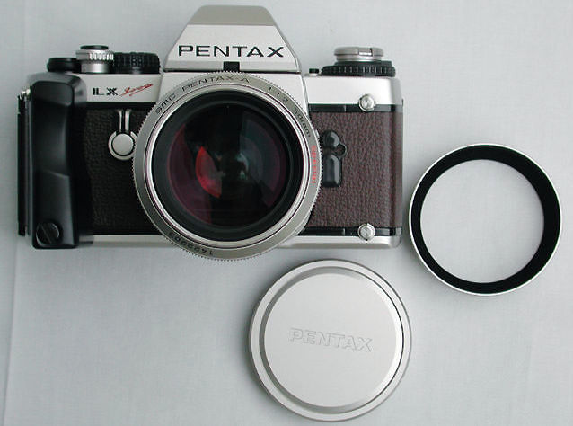

Sorry - here is a much better detailed picture to express what "good condition" should be with Pentax LX (just from optical side ) often mentioned as "mint" :
with regards
