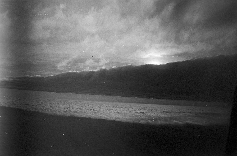

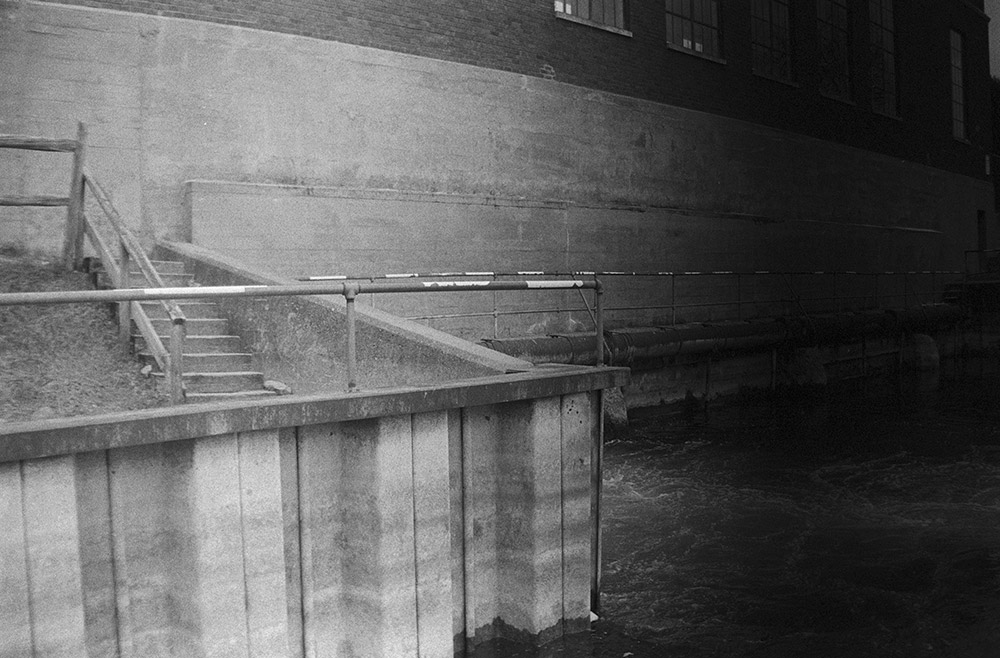

Very recently I've started getting uneven exposure with my Pentax LX. From the looks of it, something must be up with the shutter. I'm seeing a dark vertical band that can be any position in the frame with varying widths. This happens about once every two rolls. I'm afraid it might be a difficult and expensive repair. My budget is super tight right now. The repair guy that's worked on most of my stuff said that with the LX, Pentax refused to send him any parts or manuals. It was supposed to be a factory only repair.

Problems like this are normally caused by dirt or dried grease or disintegrating foam on or around the shutter parts.
You're likely to find that this problem is only occurring at certain shutter speeds (most likely the highest ones) and you might be able to just avoid using those. However if left untreated expect it to creep down into lower speeds over time.
Yup, looks like some form of shutter capping. Bad news.
So the realistic option is to find a different camera that suits your needs and budget, and set this one aside for now.

If you don't have experience servicing cameras, do not start with the LX. It's a beast.
And, yes, this looks like your shutter curtain speeds are off and they are overlapping during the exposure, rather than maintaining a proper gap.
