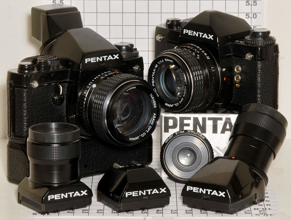

BTW, I have two perfectly working LX's that I've been using now for over 10 years with not one issue. One off auction listed as for parts only not working from a relative. Put batteries in and it's been working since.
LXs & Finders by Les DMess, on Flickr
