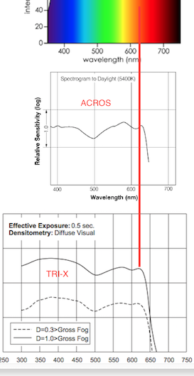

Drew, if you really want to compare published data...
ACROS has slightly better red sensitivity than TRI-X 400:
Also, ACROS has slightly higher yellow/green sensitiity v. blue, while the opposite is true for TRi-X.
(The three graphs are aligned vertically at 600nm. The chroma chart is a bit narrow.)
- Leigh
