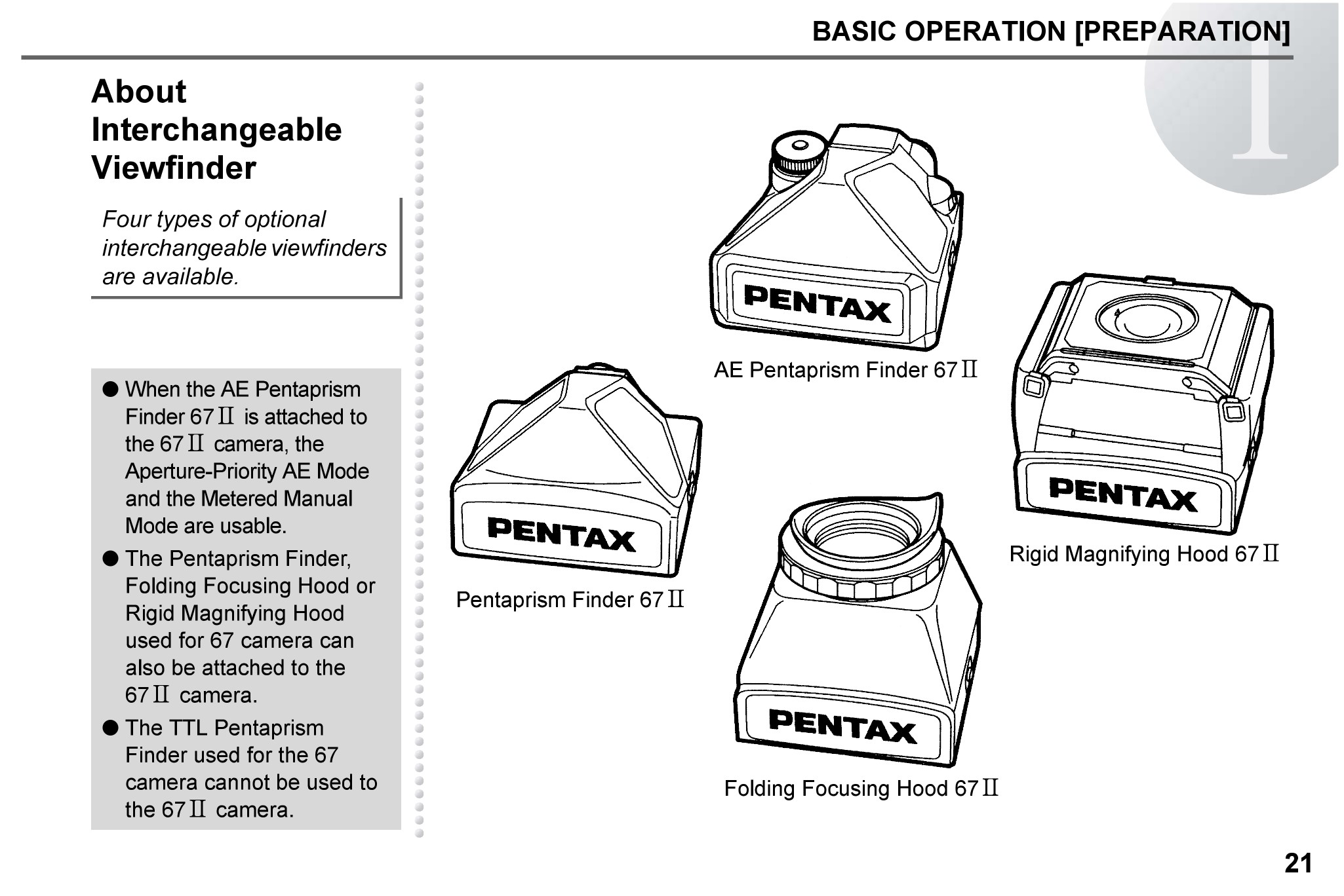

Be aware that the finders (prism or otherwise) are not interchangeable between the earlier versions and Type II. The lenses are.

According to Pentax finders are compatible, the only difference is the AEII finder, which has electronic contacts on 67II (I believe still can be put on older body as plain prism). Of course getting AEII without accommodating body makes no sense.
There's one blatant error on that diagram. They have the labeling of the folding hood and the rigid magnifying one reversed.
That is correct, still finders are interchangeable. I posted this only to clarify this one bit, and this has been confirmed by several sources - finder mounting is the same throughout the series.
