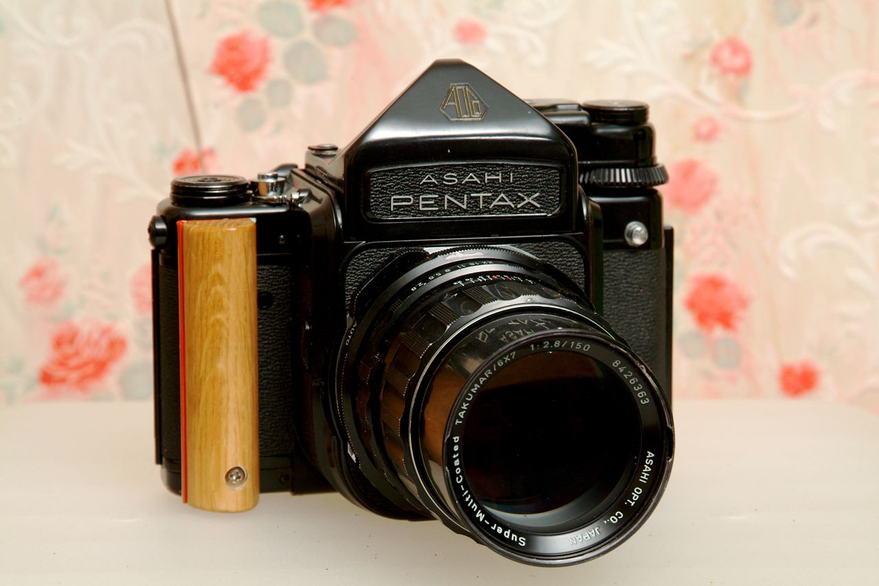

Hello brains,
I recently bought into the Pentax 6x7 world, and love the beast and its glass.
I have noticed, however, that i do not have any mirror damper in the box, and was wondering if anyone had a pdf service manual, or know-how on where the damper is meant to be, and what kind of material it should be made from. Again, I have little trust nor budget for local service men, and since the camera was a single owner machine before I bought it, I would prefer to install a damper myself than let a technician set something else wrong within my new baby.
Thanks,
t
P.S. Yes, I made the grip. Scottish oak, polyurethane rubber, scavanged steel and an A4 steel screw to lock it.

the grip does make it a lot easier, or safer feeling, to hold the camera. I think it might be more of the sense of confidence that it is not going to slip. Made in the kitchen with a hand saw, No. 5 plane and drill, as this is all I have access to right now.
