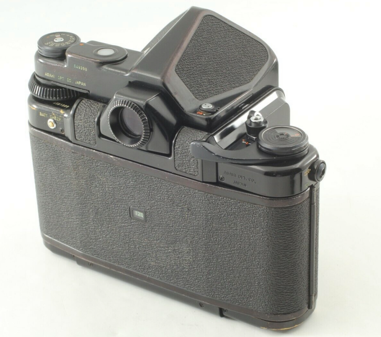

the 67 doesn’t have an adjustable diopter, but it does have a screw-on diopter, so, if you know how much adjustment you need, you can find a matching screw in diopter ring.

that manual is for the 67ii, not the 67. The 67ii does have an adjustable diopter, but the 67 simply has a place to screw in an eyepiece, and you could get the eyepiece with different diopters.
EDIT: here is a pic of the eyepiece on a 67:
You're right. P67 does not have a diopter. I mistaken you were talking about p67-ii. My apologies.
