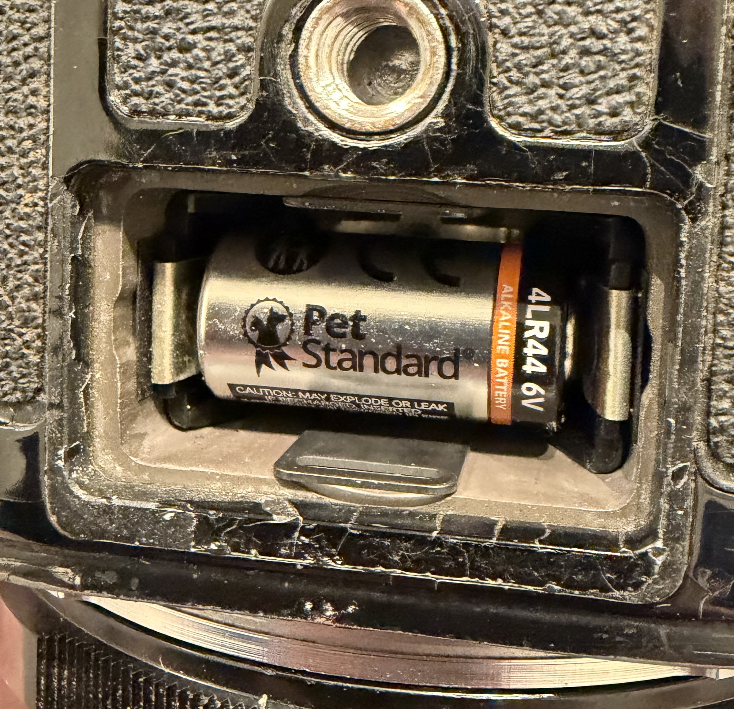

I recently acquired a Pentax 67, the first version, and it doesn’t have the battery holder. I’m putting a battery in the compartment, and the contacts are clean, but nothing is happening. My question is whether or not the battery holder is necessary, or is there something else wrong and I have a literal brick? I do have a battery holder on the way.

The P67 will operate without the holder. However the P67 won't cock the shutter without film; there is a way to do so that is outlined in the manual (open the door, turn the counter passed "0", close the door).
Try that, then make sure the battery is good and in the right polarity.

To add to what OAPOli said, the first time I used this camera I thought I had a brick as well. It not only needs film but needs to be at frame 1 to fire. I had winded my roll to frame 1 (or so I thought) and it would not fire. It turns out it only looked like it was at frame 1 but wasn't actually there yet. You will feel a noticeable difference in winding between frame 0 and frame 1 with film in it.
All Pentax 6x7 / 67 cameras (meaning, from the first generation in 1969 to the last in 1992) have a safety interlock feature that prevents firing of the camera if there is no film loaded. This is easily bypassed for testing purposes with a bypass key inserted under the film counter dial. It is not recommended as standard practice but is useful when resetting the counter window to 0.
I can confirm that neither of my two Pentax 67 (final generation) cameras will work if the battery is not in its holder (and film is loaded). I cannot see anything to suggest that the battery holder physically interplays with something else, other than latching to the body. I don't see how it is reasonable to offer a camera for sale if it is missing an OEM part essential to its operation like the battery holder!

Thanks everyone for the replies. I tried turning the frame counter with the door open and it seemed to do something, but now the mirror is stuck almost all the way up. Also the check battery light does not come on.
Unfortunately returning it is not an option as I got it through Zen Market, a proxy for Japanese auction sites, and for very cheap. So either I tinker or sell it for parts and cut my losses. Although I may try a sacrificial roll once the new battery holder shows up.
What you are describing occurs when the shutter is released with no power. You can reset the mirror via the little button under the shutter release trigger on the front plate. Please look at the manual.
It appears that your battery is either dead or in the wrong position. There is a good chance your camera is okay.
For the benefit of the OP, resetting the camera:
(Assumes film is loaded)
Ensure the prism is locked down in place first and a lens is mounted.
1. Use a toothpick to press the deeply recessed button, left of mirror box, once only
2. Fire the shutter; and
3. Wind-on.
This sacrifices one frame of the film and resets the mirror, solenoid and shutter release.
