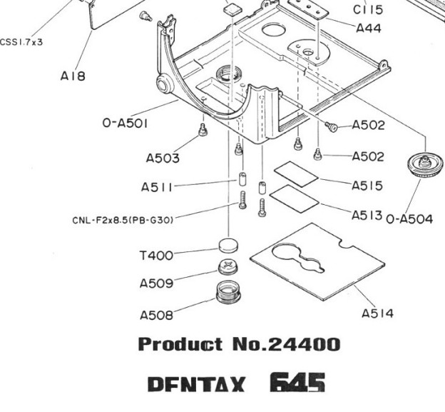

I looked up an exploded view of the P645 in the service manual and is shown in the image below. The Lithium battery is indicated as T400. I'm trying to recall if I've taken that cover off, but if I get some time later today I'll take a look and give it a try.
I also can't recall if I purchased the service manual or "found" it on online. Age related "Can't Remember S**t"!

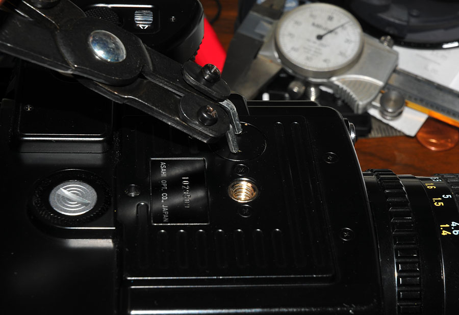

Thanks again Mark. I don't know about spending $50 for the tool for a one time job. Maybe I'll get some $10 retainer ring pliers or take it to a local camera shop and see if they can change the battery. The serial # on mine also starts with 102. I was hoping you knew how old yours is because they're probably the same age. But if you bought it used I'm sure you don't know.
I went to Sears and picked up some $10 snap ring pliers and got the job done. Thanks for all the help APUG members.
