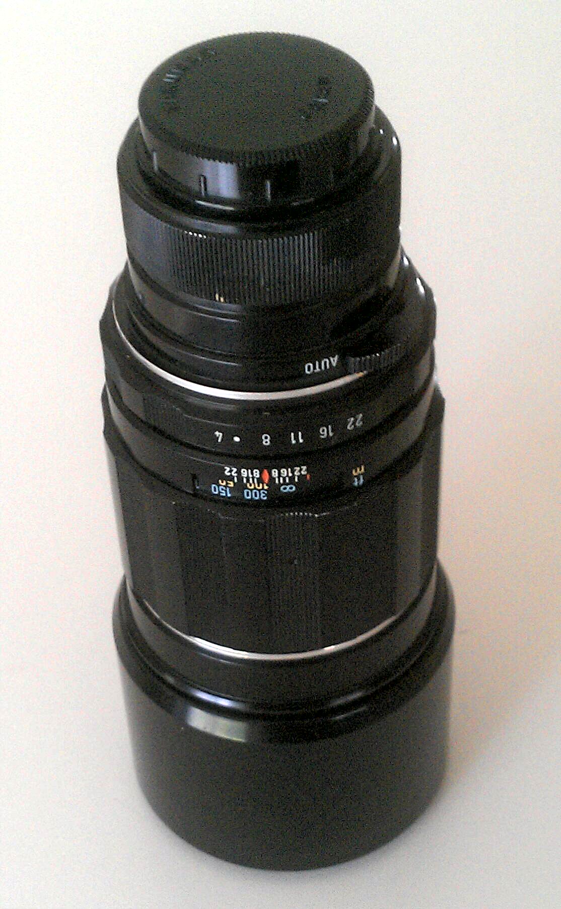

Thanks everyone - I have a lead on a SMC Takumar 300/4, but I found someone who can show me the old f/6.3 as well. Decision to come in a few weeks.
Theo Sulphate
Theo Sulphate
Jul 3, 2014
6,489
Gig Harbor
My decision was to get the SMC 300/4, although it doesn't have the collar. I suspect I'll have to prop the lens up with a folded hand towel for stability, as I don't think the collars are easy to find.
