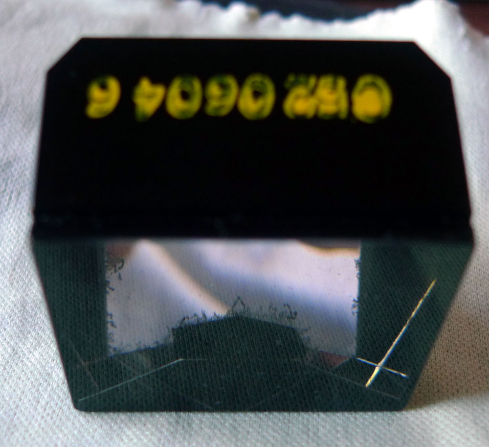

I need to replace the glass pentaprism block in a Nikkormat FT3.
I was thinking of acquiring a cheap "parts" Nikkormat FTN online purely for the pentaprism block - can anyone tell me whether the pentaprism glass blocks are identical/interchangeable between these cameras?
Thanks, P

Thanks for your response. In general terms the glass seems very good, no de-silvering or corrosion. The problem seems to be black fungal growth actually inside the block as if something is growing in between elements of the pentaprism block. It looks like the prism is built in multiple sections.
I've uploaded a quick phone snap of the black mass growing inside, not a great image but I think enough to get the gist.
I've never seen anything like this before - has anyone else?
