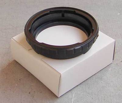

This must be the Hartblei adapter (very first one without engraving):

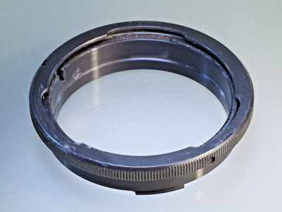

Or this one together with the lens:
I appreciate the pointers. I’m confused by the first one: It says “für Pentacon” (Pentacon Six adapter for Pentacon??) and I didn’t see that it mentions the M645. The second one with the adapter already on a lens looks like a good deal though.

Oh, my bad, sorry. This adapter appeared in the search results and I just looked for the overall shape. It is worth to ask. If it its not for Pentax645 though.
Hmmm, it looks like shipping on the big lens is prohibitive, and the seller of the adapter doesn’t seem to know what camera it fits. I may have to go with one of the basic adapters and hope for the best.
