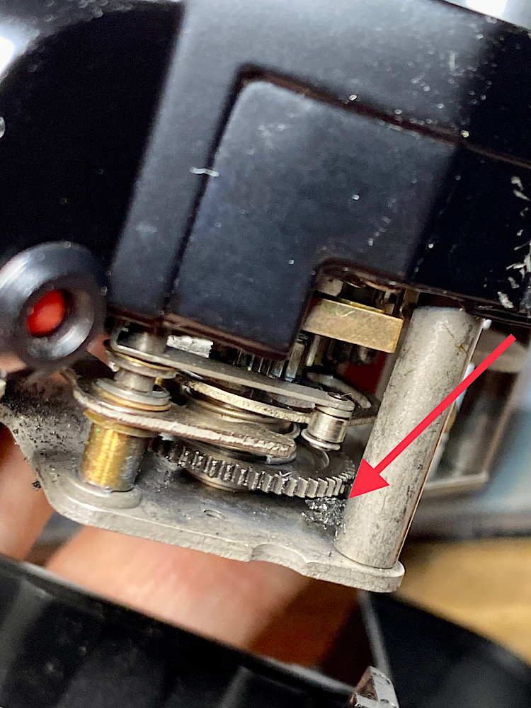

I am lucky to have a Pantencon six with w MC Biometar 80/2.8 in low price (US$ 50 🥳 ) . The lens is fine and clear , while the camera seems have been dropped so the frame counter needs some attention. The camera works fine with the high speed and B but not the slow speed down to 1sec. I followed the youtube/Rick 's page and opened the top cover , having cleaned most of the old oils at the left side (under the speed dial) then I have also used new lubricant (Moeblus 9010) for the timing gears . The slow speed worked while testing and I am vey happy.
But after sitting there for a night the slow speed is down again. I can see the 1st curtain not open well. So I wind it up again and giving it few times for testing the camera is back to normal.
Is that means there are some places I missed and I should clean as well ? I know the Right side have wheels to drive the curtains and a level under that connect to the slow speed gear . Do I have to clean them as well ? What lubricant should I use ?

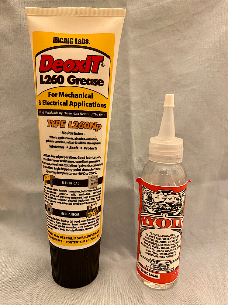

These are my two universalists with whom I do most of the work:
The German word „Fett“ means „grease“ in English.
That has enlightened me ! Thank you so much!
I know Nyoil for years but it is not available in my local market, so I just keep using Moebius for quick moving parts & clockwork gears (e.g. self timer) and Ardent fishing reel grease for the slow moving part.

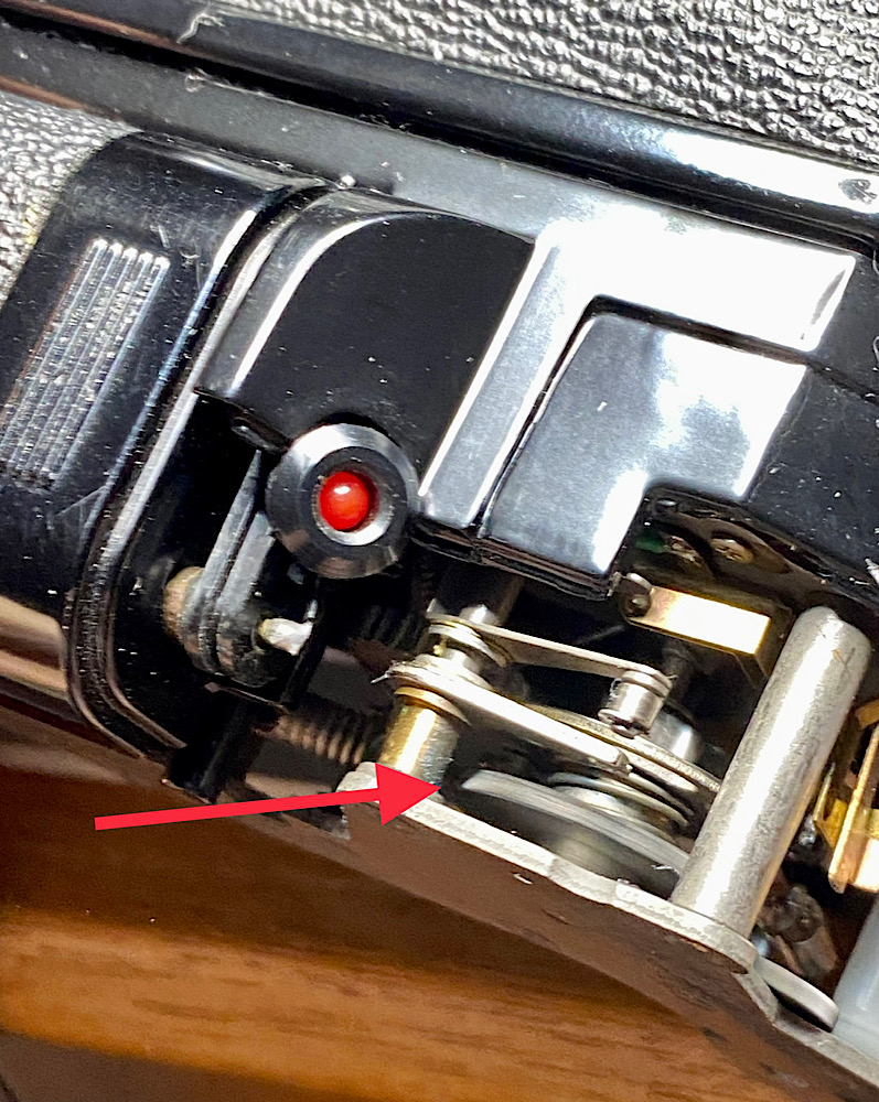

A bit update here and I think I managed to locate the problem. It is about the grease. I need grease on the catch (from the lever bar) to the up& lower shutter drive wheels, also on the another end of bar to the timing gears.
I tried it with Moly lube, it does it job especially with high speed ( particularly 1/125 or higher) but the grease won't stay long after few attempts, especially after changing of shutter speed (from 1s to higher and then back to 1s). It looks like the lubes being driven out from the catch and so it stuck at the middle again.
what grease would you recommend , that could be on the metal wheels while doing the lube function? 🤨 Should I go with soft (less likely?) or firm grease?
