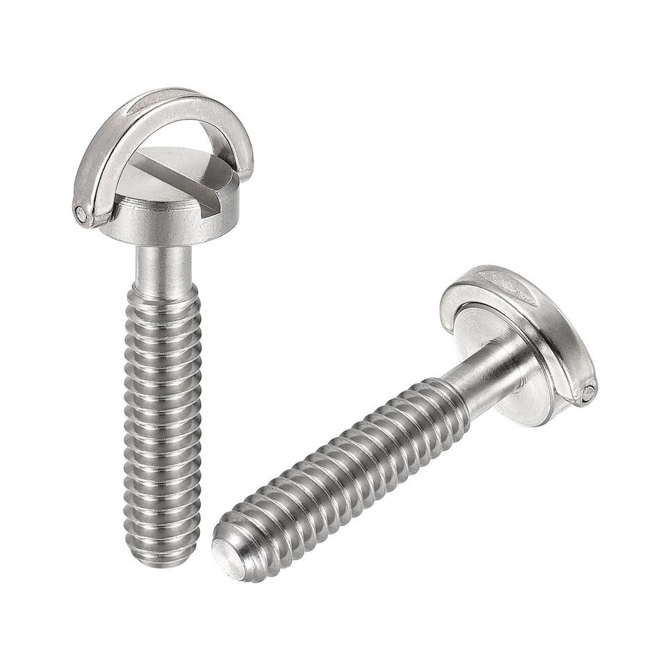

Yes, I could get a dual camera mount and possibly get one of this (30mm long) for the camera
and drill a slightly wider than 1/4 inch hole and secure everything tightly.

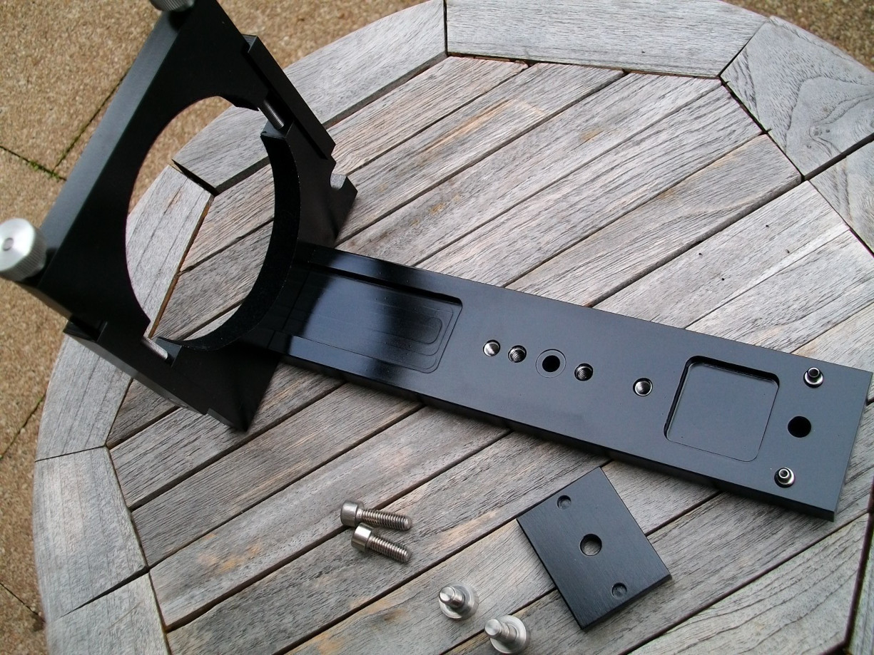

But I have found something like this for Sonnar 300mm f/4 and I wish they made one for 180mm too...

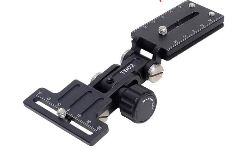

Search "Foldable Long Focus Lens Support" on amazon and you will find something interesting.
yes, that would fit perhaps for all heavy lenses.

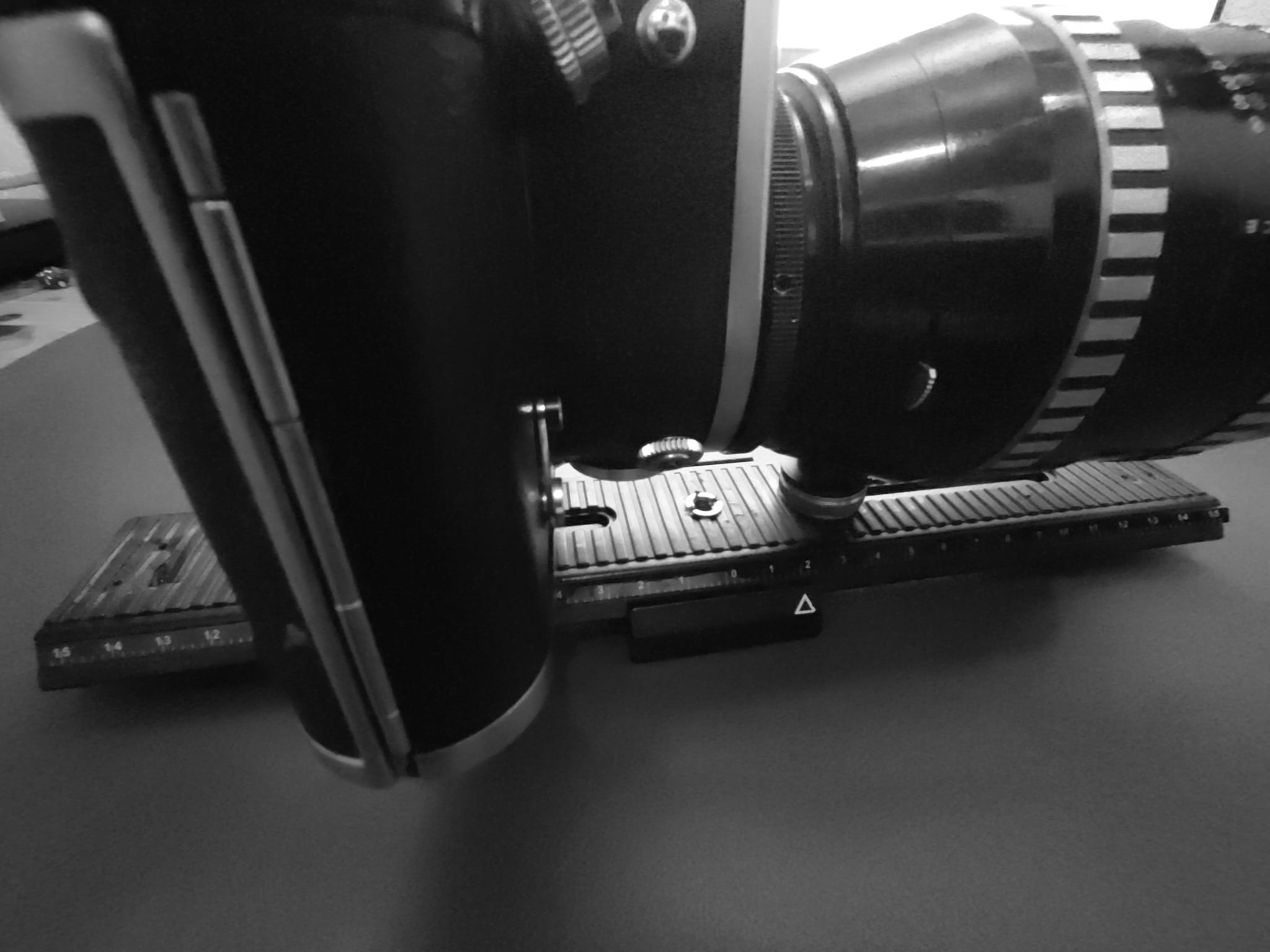

I looking for a bracket that goes from camera to the lens or a bit longer.
Distance from the camera to the tripod socket is 20mm, either a screw or a 3d-printed spacer secured by a screw.
All together compact and light was the intention to ask this question.

Just to report back that the above shown TB02 flexible bracket does not work with the Pentacon Six + Sonnar 180/2.8. The bracket is too long, regardless of how I adjust the three pieces. So the hunt is continuing.
if the bracket thickness is 5mm then you may need 30mm mounting screw.
30mm = 20mm (distance between two mounts) + 5mm for the thickness + 5mm for the screw depth (it could be little shallow than this)
