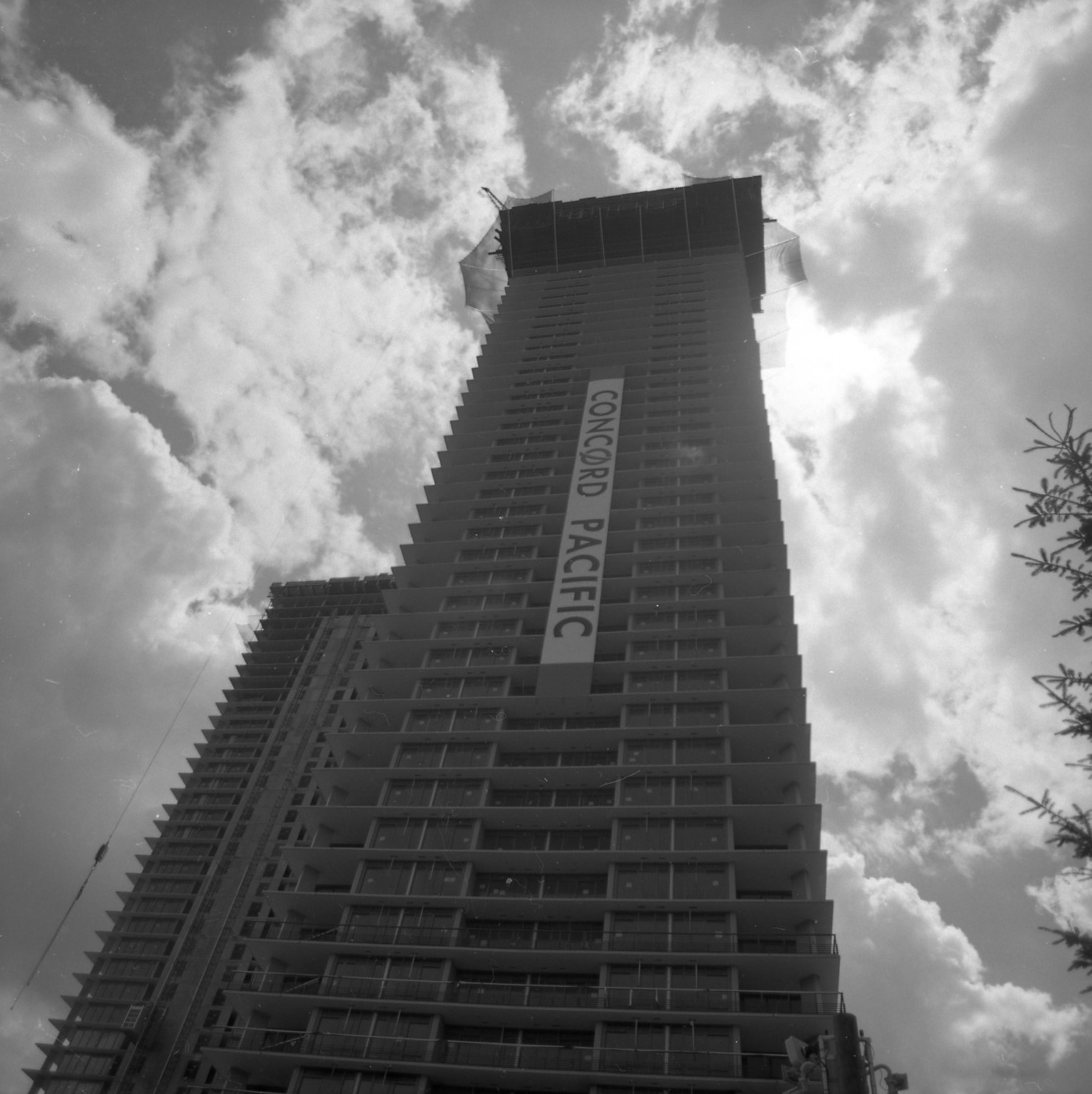

This was pretty intense with the sun in the clouds and I don't notice too much flare (Pentacon 6TL ,80mm MC lens) . I wasn't sure it would come out at all ! Peter
