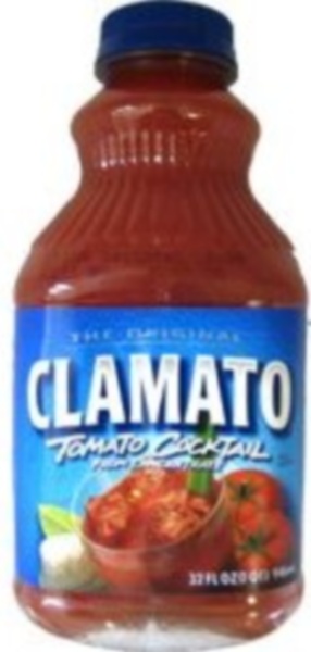

How many gallon jugs and other size containers do I need?
The answer depends on what you decide to do, which versions of chemicals you choose and how much space you have for storage.
I make a lot of use of US 1/2 gallon juice containers, because those containers fit into medium size bins which in turn fit into the storage space I have available.
These are the containers I use (I like Clamato juice)
The contents are consumed, the labels are removed, the remnants are thoroughly washed and rinsed out and new labels are added by me.
I do a fair bit of toning, so between my film replenishment regime, re-use of film fix, temporary between sessions storage of some or all of my working strength printing chemicals and my re-usable toning chemicals sometimes I may have as many as 10 of these on the go at one time.
I also have a big, 4.25 litre jug with a lid that I pour spent fixer into for taking over to my friends who harvest the silver out of it.
