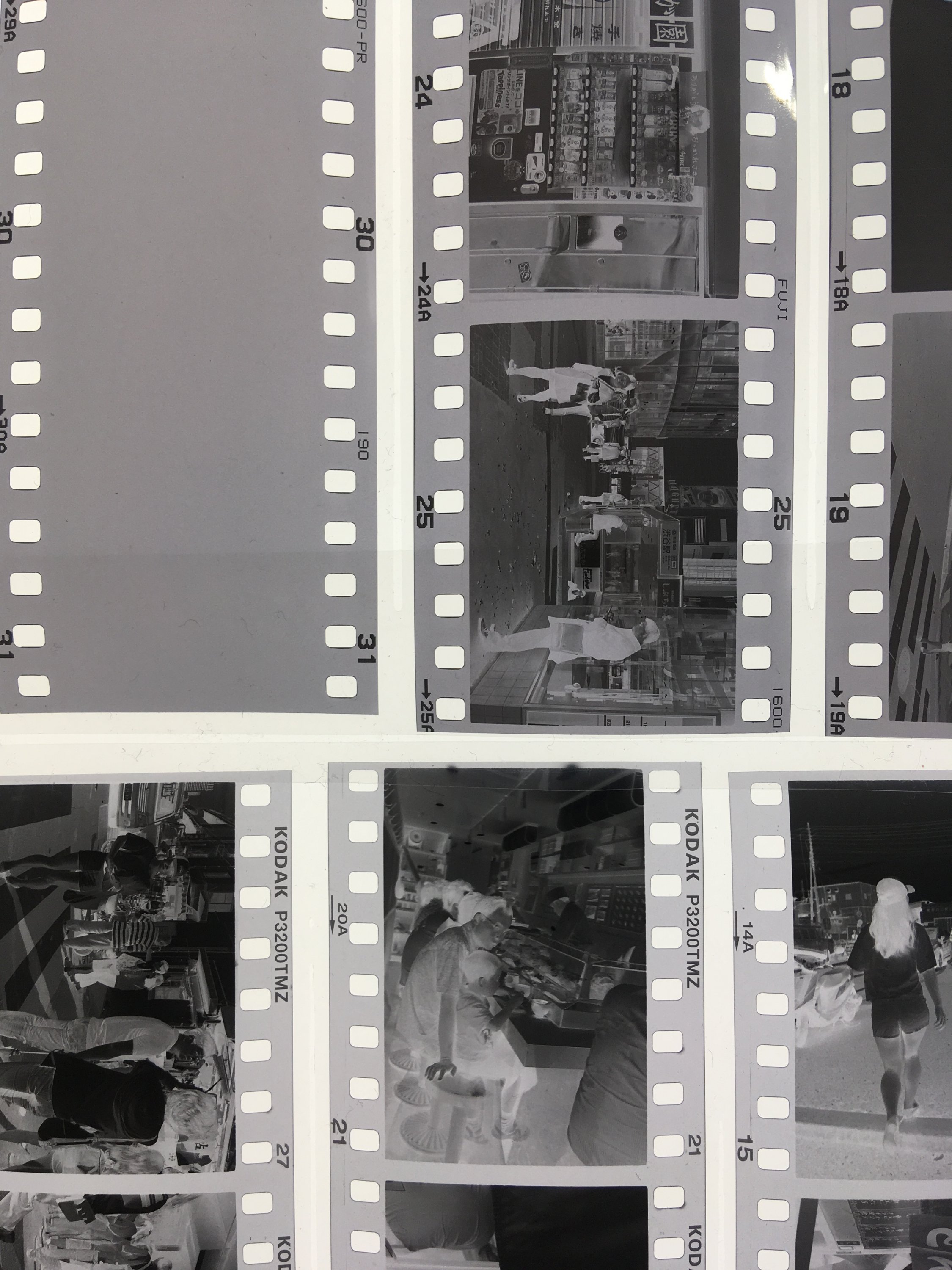

I have a few rolls of Neopan 1600 aka Super Presto from 2012 I think. Super heavy base fog compared to TMax P3200. Also, I barely get 400-500 ISO out of this film. That is in Fuji’s Super Prodol developer 1:1. The TMax was developed in xtol.

Hmm interesting. Maybe I should try to develop it in Xtol instead then and see what speed I can get out of it. I only have another 6 rolls.
TMax P3200 is extremely sharp in xtol and I can comfortably shoot it at EI 2000.
At least in Super Prodol the Neopan 1600 isn’t nearly as sharp.
