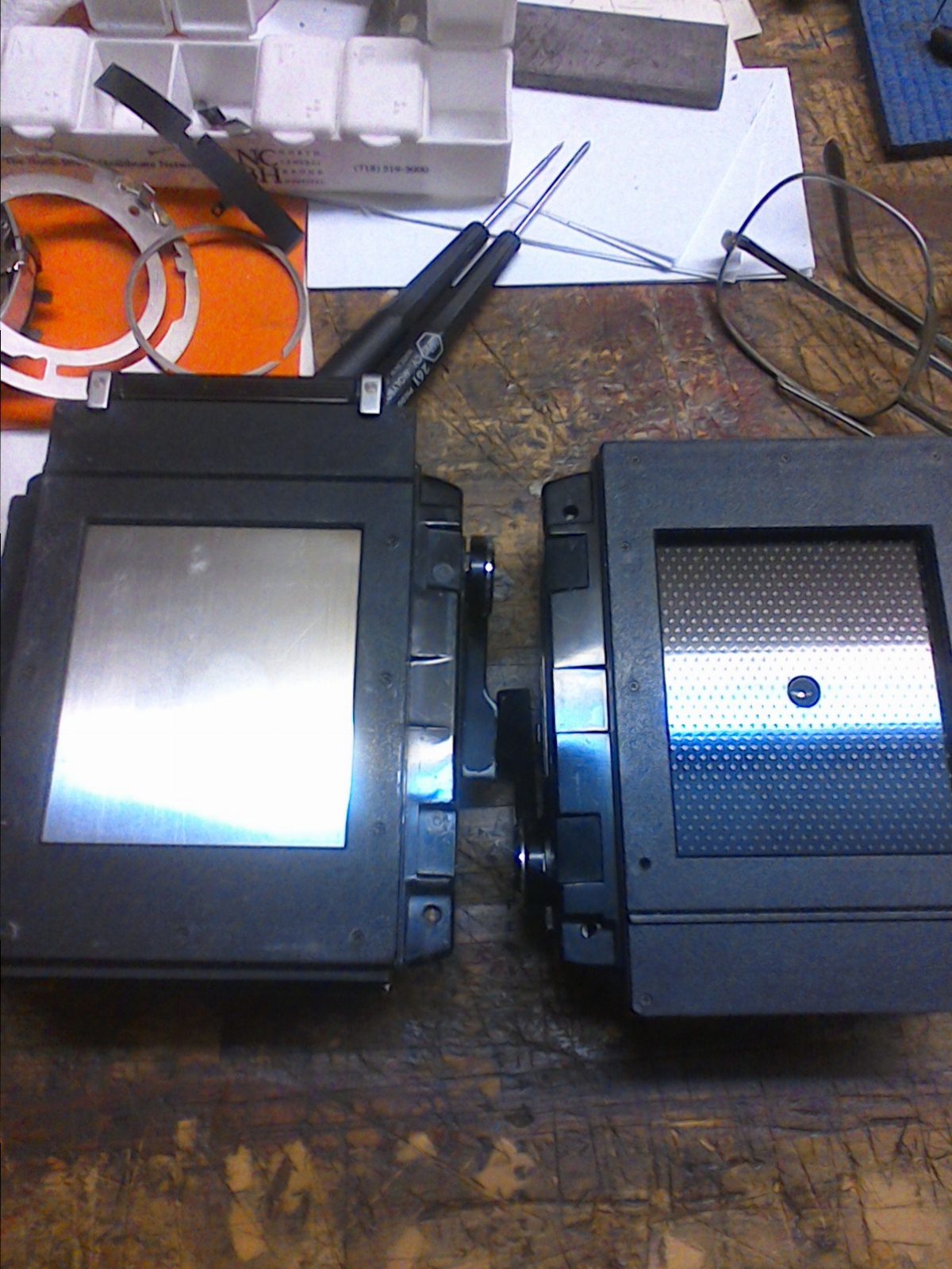

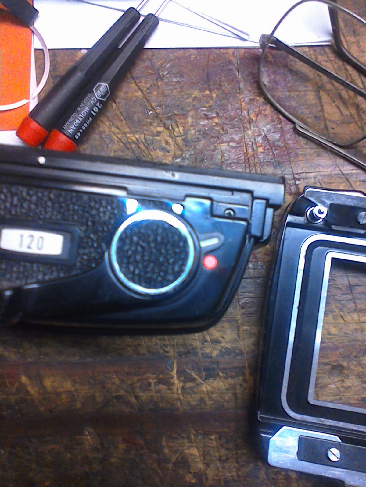

ok pictures...

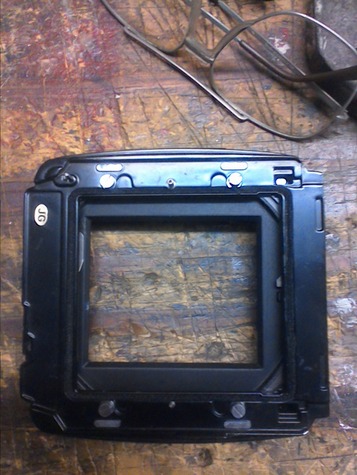

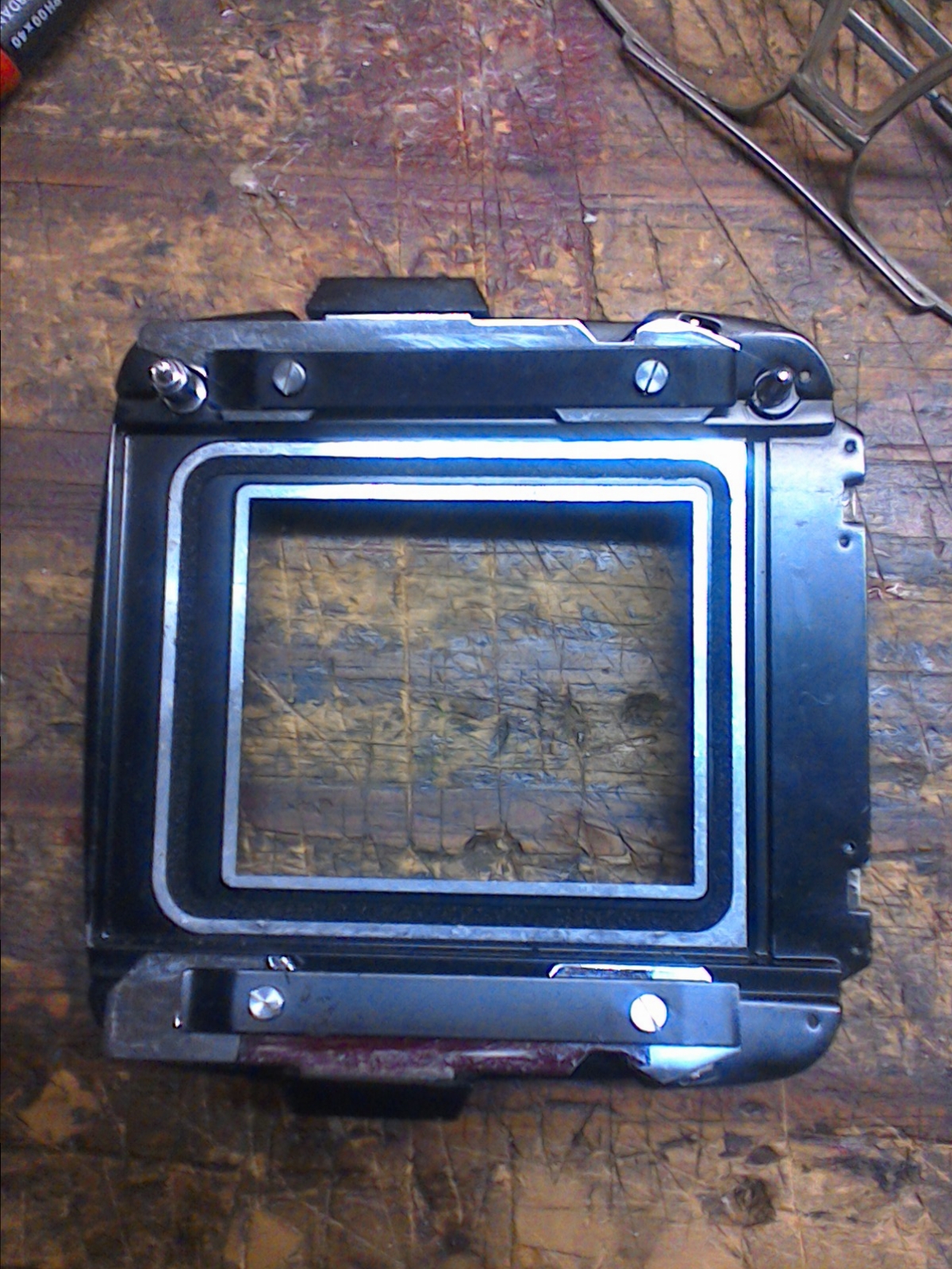

see the screw in the hole on the top right? vertical, push that... also when half rotated you can see the other side

first pix show rb vs pro s film back... dark slide is rb, note corner holes? 1 on the rb
2 silver tits on rb pro s rotating back

in that square hole....

someone switched your rb inserts into a pro s shell
