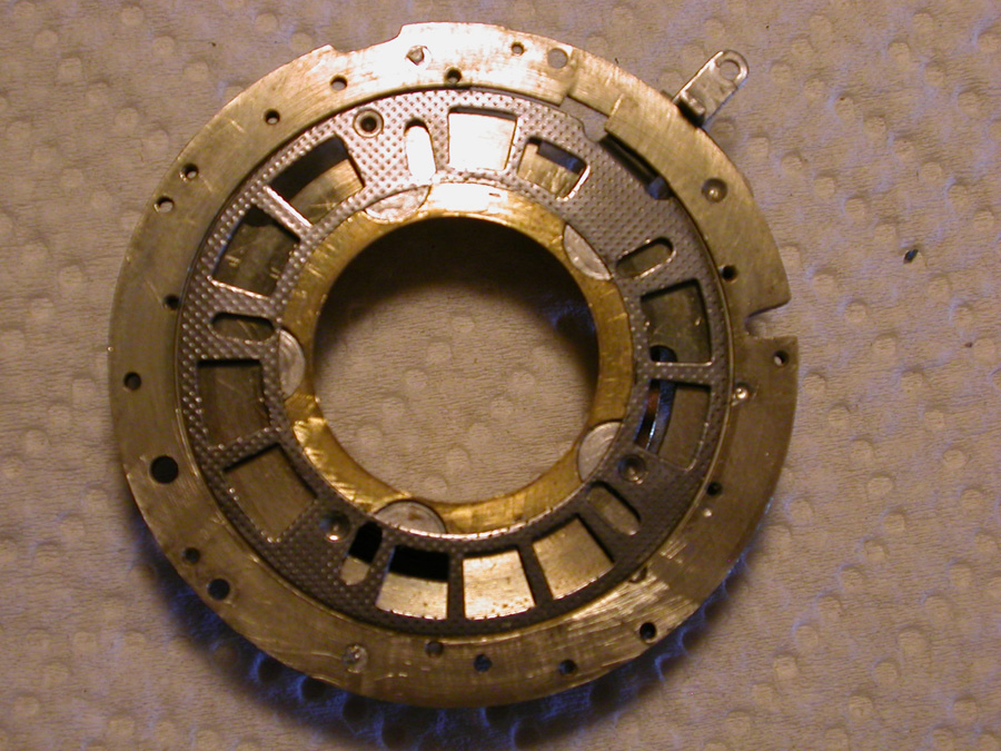

This is the blade controller.. there talking about, not the blades.
"2) On the inside and outside of the diameters of the blade controller."

Yes that's a blade controller. All shutters have one. As one becomes more familiar with servicing shutters the more obvious typos, incorrect procurers, and similar errors. A tech sheet may have been issued to correct the error but replacement manuals were not printed. Once a company releases manuals to the public domain such tech sheets are frequently lost or left out.
I guarantee that if you tear the shutter down, lube the controller as stated and reassemble the shutter will not work as well as it does now.

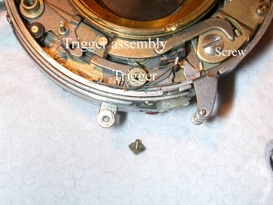

Denverdad or anyone else.. some NOTES on the manual.
Disassemble figure #9-10 Release lever assembly is illustrating Old Style release lever, 107936. To see this, refer to first section of the combined manual of Parts List NO. 6201, page 5, at the top.
My shutter had the newer lever assembly 107844, with the added part. This assembly cannot be taken out as instructed on figure #9-10, UNTIL you remove the Trigger assembly first, figure 17-18. As that added part, of the release lever, needs to clear the centered brass lens mounting, by being moved towards the outside of the shutter housing. To help facilitate this, one also has to remove the the screw from the sychro sector assembly, figure 19. So that the newer added part, does not catch the screw as you slide it towards the outside of the case. In reassemble one has to put this part back in, before Trigger assembly.
Also once you have steps, disassembly figure 1-7 done, go to figure 16 and lift out the high spring lever assembly, as its just floating in there on its stud, and if you flip over the lens as your working, the dang thing will try to fly off to never never land. :surprised:
