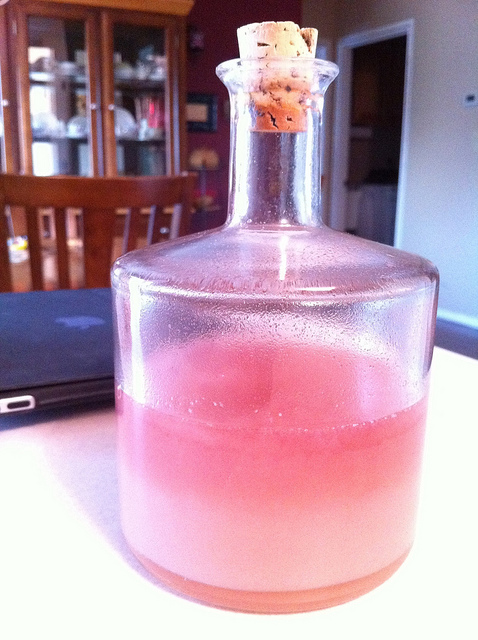

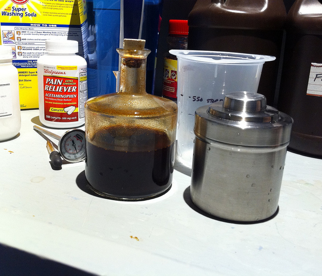

When I originally made it, it turned pink after 1 day, and then turned Poopy Brown, just like my bottle of Rodinal. Same formula times. It is a bit cloudy from all the chemicals but as you can see by my photos, it is working good. So far I have used it 1:25, 1:50 and this weekend will probably do some 1:100 stand development to see how it works out.
Greg
