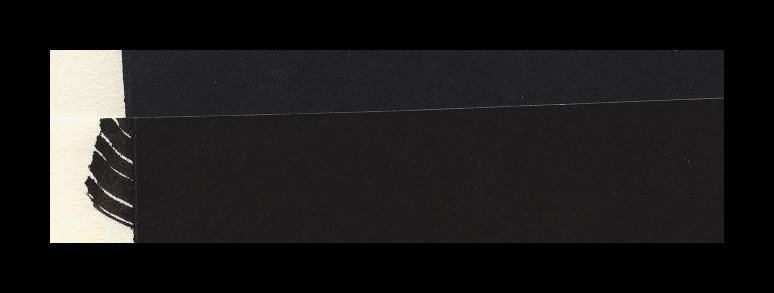

If you like Ziatype and can source ammonium tetrachloropalladite(II) - formula: (NH4)2[PdCl4], I strongly recommend that you try the actual print out Palladiotype process; Ware-Malde Palladiotype. I'm totally converted to it; it gives me much much stronger (= considerably darker / better dmax...) images!
The problem with Ziatype is that the stock palladium and iron solutions have quite weak concentrations (still, they give perfectly fine images...); OTOH, with Ware-Malde Palladiotype you can use up to 50% more palladium per given image area, and this translates to significantly better results - at least to me. (See the attached scan of two prints made on the same paper; one Ziatype, one Ware-Malde Palladiotype. The lighter upper part is the Ziatype, the darker and larger bottom part is the Ware-Malde Palladiotype...)
