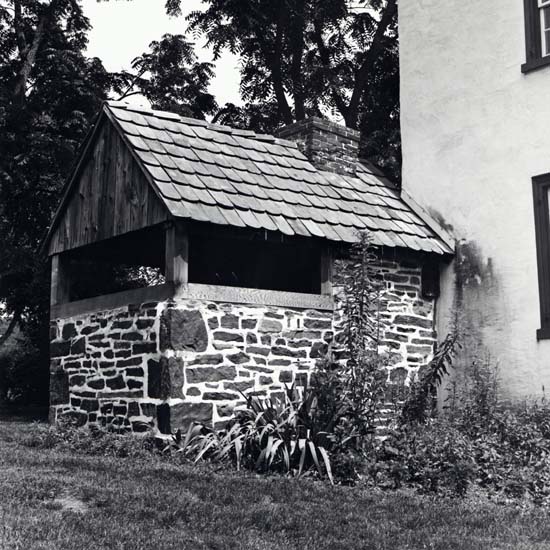

OK, I just celebrated Tuesday by printing some black & white shots from my recently acquired SQ-A. This is after a brief darkroom hiatus of -- oh -- 25 years! I vaguely recall needing exposures of half a minute or maybe more back when. And today, I was down around 4 or 5 seconds at apertures of f22 to f32; felt like I was running out of control.
Back when, I used a rather crude homemade enlarger, and now I have a new to me condenser enlarger, an Omega B-8, and I have the correct mid-size supplemental condenser lens to go with the Nikkor 80mm f5.6, so I suppose I'm really optimized. Actually, it occurs to me that one factor could be less magnification required for generating 8 x 8 inch prints from 6 x 6 cm negatives compared with 35 mm. At any rate, I feel like I should be looking for a neutral density filter. :confused: (Or a 25 or 30 watt versus 75 for the PH111 enlarger lamp.)
Today's tries were on Oriental Seagull and on Ilford MGIV -- anybody have any idea how these compare in speed/sensitivity with the "standards" of yore -- like Kodabromide or Polycontrast?
All in all, I'm pretty happy with what I'm seeing, just a little surprised at what feels like instantaneous exposures on the raggy lower limit of my (also crude) homemade enlarger timer.

10 to 20 seconds from f/8-f/11.
Yeah, that sounds more like what I was expecting. It never crossed my mind I'd ever see an enlarger with too much light output! This AM I actually tried an A-B measurement with an Ilford EM10 using the existing bulb and a new one I bought for a spare. The new one was dimmer, but within half a stop. I've seen household bulbs get a twisted filament and put out about 4x light once or twice -- but usually only for a very short time before they start emitting darkness.
Maybe when I get some time again I'll change it over for 35 mm and print a few of my shots from Argust 6th. Be a chance to see if it acts any different. I sorta take back my comment about 35 mm vs MF magnifications in the original post though. Now that I'm awake, it seems like that would not apply, assuming one uses condensors and lens matched to the format being enlarged.
I'm not really concerned about an ISO speed for the paper, I just wondered if paper had gotten as much faster as film has in the past 20 years! (I shudder to think of putting some ISO 800 stuff thru my Brownie Target!)
I should check my line voltage -- my local power folks have been a little generous lately. Somewhere I have a 100 VA constant voltage transformer, I should explore the dark corners and find that.
OK, enough thinking out loud for now, thanks for the comments.

could your film be thin?
Well, I suppose that's another area to contemplate, although I have to wonder about two or three stops thin. I admit to concentrating more on general handling of this larger hunk of camera and finding film back light leaks than exposure. I guess a little more careful investigation of my "personal film speed" might be in order. I thought the negs generally looked pretty good, but I suspect "good" is not a universally agreed standard. What the hey -- an excuse to go out and take more pictures!
