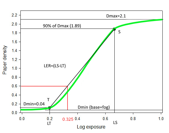

ISO(R) is a slope, so you can get a ballpark figure with some trigonometry. Of course, every contrast grade for which you calibrate will have a separate ISO speed and contrast.
Not exact but it can give you a ballpark figure.
