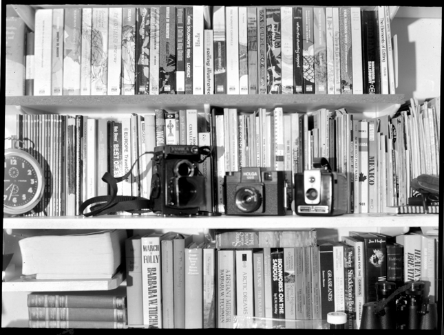

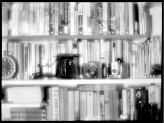

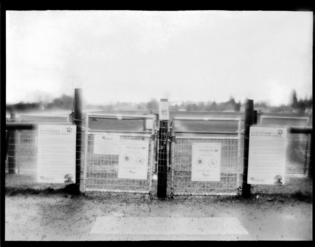

Here are three paper negatives (scanned and inverted, just for a quick test)...
The Fence gates were shot using my 285 Wollason on a dull Pacific Northwest day.
The bookshelf photos were done using my soon-to-be-anounced 335mm Wollaston Meniscus lens.
Both were shot using a beat-up 8x10 Kodak 2-D
On paper negatives, of course.

A bit about the three examples in my first post:
The paper is VC Ultrafine RC.
The bookshelf photo's were shot thru a YG (X-0) filter.
I didn't have a large yellow filter to help control contrast, so the YG had to do.
The blend of Yellow (lower contrast) and the Green (the low contrast component of VC papers) did the job.
I like the results, the various colors of the book spines recorded a nice mix of gray tones.
I didn't meter the subject, just a bit of byguess/bygolly (±5 second exposures).
The outdoor photo (gates & fence) was without a filter.
I used ISO 3, but should've used ISO 6.
Developed in some old pseuodo Ansco 130.
One glug of 130 + 4 glugs of water in a tray.
Bookshelf negs developed ± 6 minutes.
Outdoor shot (overexposed 1 stop) developed ± 1.5 minutes.
