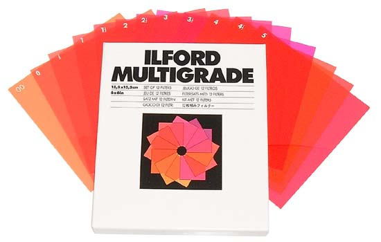

Hello Reinhold,
Thank you for this valuable info.
I was thinking, when using an enlarger (for regular printing) I use special multigrade filters for variabel contrast (vc) photo paper to control contrast from grade 00 to grade 5. Couldn't I use the same filters (instead of normal filters for film) to tame contrast in camera as well?

A light yellow #8 filter only increases exposures about 2x or 3x for me, and the paper negatives print with a tonality almost like photographic film. An orange 21 filter slows the paper negatives down so much it makes lens cap exposures with antique petzval lenses wide open in broad daylight very convenient. This is with VC RC paper.
Toadmen: I believe Simon Galley posted some time back that VC enlarging filters can be hand held in front of the lens and give the desired results.

Remember that the MG papers are expecting a tungsten light source, while the sun is a lot more blue than that. The blue-sensitive emulsion in MG is the higher-contrast one, so "hard" results are to be even more expected than, errrrm, expected. Using a yellow filter will reduce the amount of blue light getting through to the harder emulsion, as mentioned by desertrat above. It may be more practical to use a fixed-grade paper for the neg, possibly flashed, then contact-print on MG with a filtered enlarger as the light-source? Comparison results available soon, when I receive my order with fixed-grade RC paper in (and it stops raining).
