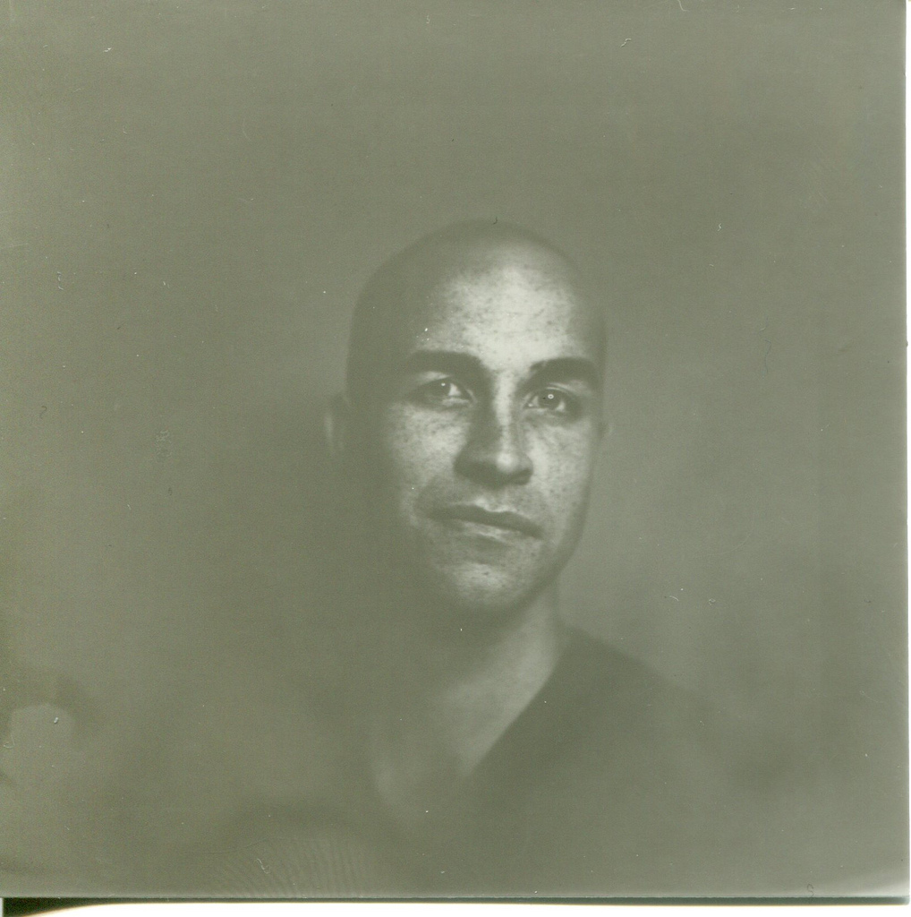

This thread inspired me a little to try making reversal photographs straight out of the camera.
However, my approach has been to employ the Sabbatier effect onto a contrasty and medium dense paper negative.
This results in a positive with a good range of tones and fair crispness, but it definitely constrains overall contrast.
I definitely haven't mastered this technique at all, but I have made a few nice looking images fooling around.

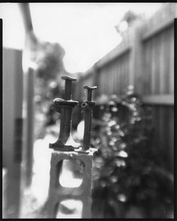

This is a self portrait that I reversed, scanned, and photoshopped a little to improve the contrast range for better computer screen viewing.
I have attained fairly normal (say a 4 stop range) level of contrast on more recent experiments, but the pictures themselves don't look as nice.
This was on some highly expired Ilfospeed Grade 3 RC, in 6x6 format. I find better results come using full strength developer, and a flash to reverse the negative.

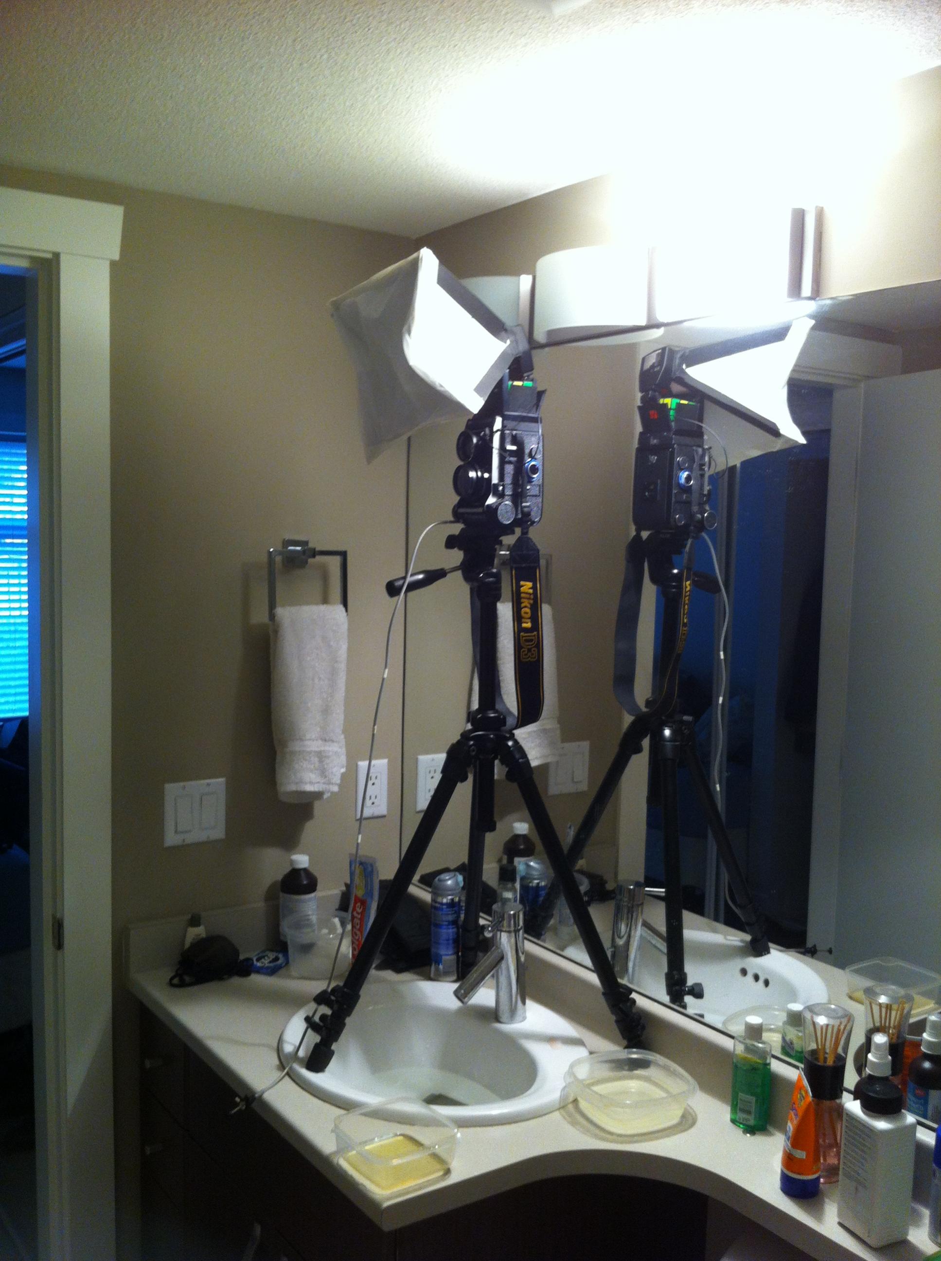

okay, took some time this morning to revisit the process!
here's my setup in my bathroom:
i've obviously got my camera, homemade softbox (on a really wimpy Pentax AF160 i got for free, supported by a rubik's cube on top of the focusing screen), single halogen light source, 1:8(ish?) ilford multigrade developer, a water bath for stopping and washing, and rapid fix.
the whole approach is very imprecise, because i'm dealing with expired paper and didn't want to get my phone to use as a timer while i was in there banging the portraits out. i metered the bathroom light at EV 3.5 for EI 12 (which i estimated a full stop slower for the paper, roughly--so more like a true EV 1.75 for EI 6) with my handy little incident meter, and the softbox i'm eyeballing off the exposure chart on the back as a half-stop under normal ( EI 25 @ f8, 1m = EI 6 @ f2.8, <1m + power reduction from diffuser). the flash exposure came out fairly close to true, though a little under. however the mostly-flash exposure (shortest shutter-open time) came out the nicest.

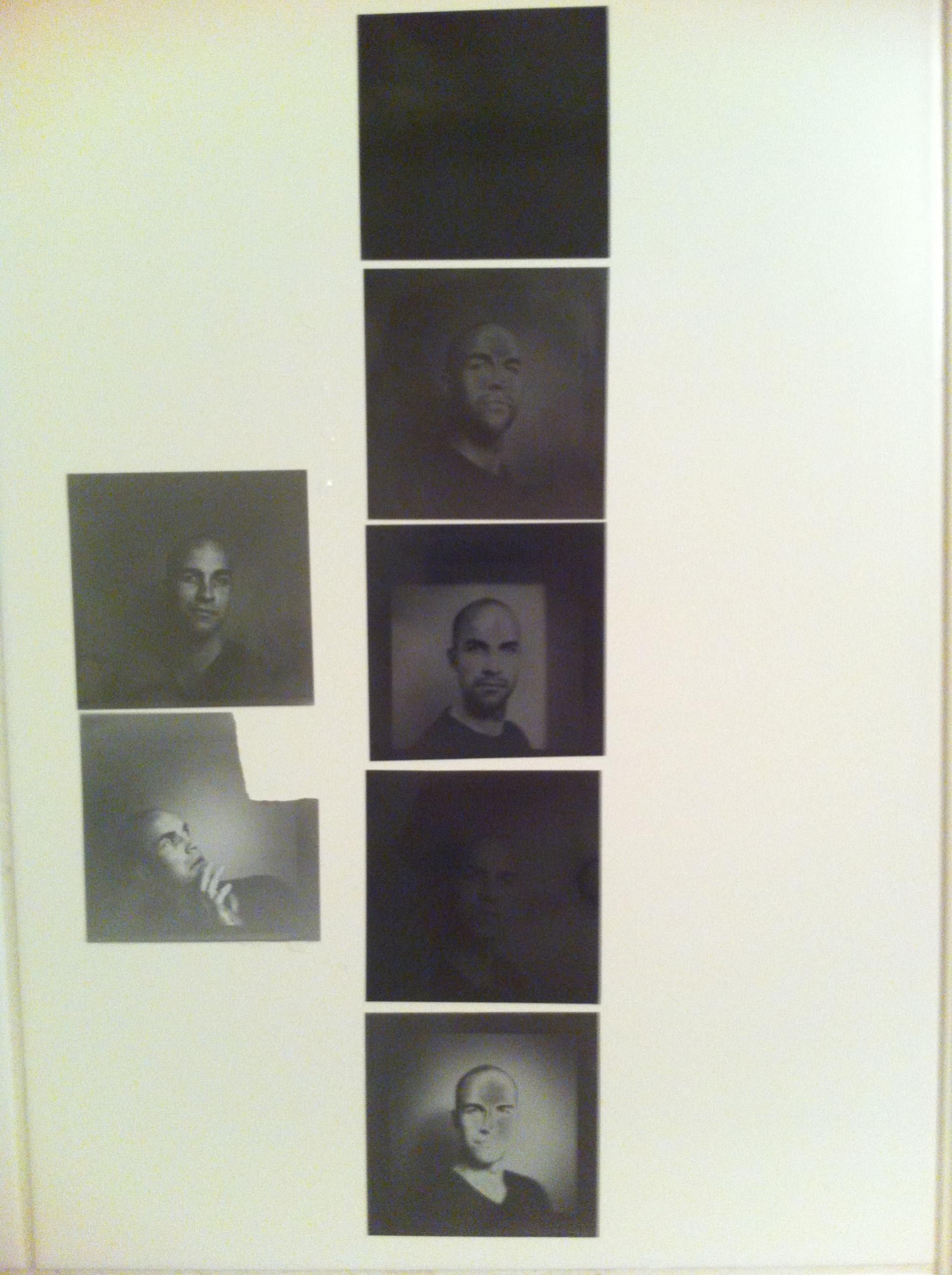

the procedure for each was to expose, fog the plate a touch with light through the crack at the bottom of the door (~1 s), develop to completion in darkness (~1 min), flash the bathroom light to initiate reversal (0.3 - 0.1s, you get a good look at the negative at this point), develop to completion (~50 s), put in water stop bath for ~10s letting the developer work its way out (and at this point your eyes have well adjusted again and can clearly see your plate has darkened), fix for whatever feels comfortable and wash in the sink for a couple minutes.
these are the fruits of my efforts today, arranged top to bottom, right to left. the first was a gross underexposure (i had accidentally left the stop at f8). the second shot was as lit as i could possibly get it for ~4s exposure and the flash, and reversed with ~0.25s of bathroom light--it came out with badly blown highlights on my nose and forehead that did not reverse. i believe that this unwillingness of fully developed halides to reverse means there are very hard limits on the maximum contrast ratio that can be captured with this process.
the rest of the shots in the right column were experimenting with exposure and flash time. when i do proper scans of these images i'll make a post of my recollected exposure data (whatever that'll mean) in a later post.
the two (i feel) more successful exposures on the left column were the last two, and were a bit different. these exposures were for shorter times, roughly 1.5s, and when flashed with the overhead light showed almost no density at all as a negative image. in fact, for the top image on the left the paper was completely white, i couldn't see any density at all when i flashed it, and agitated it for a good minute and a half in the developer hoping i could get something out of it. the lower image was about the same for exposure and density when i initiated the reversal, and just trusted that i'd see something. obviously they're much lighter in tone, but i'm happier with them as there are very little to no unreversed highlights. i believe this is a factor of both shorter exposure times to avoid blowing highlights on the front end, and more gentle reversing exposures.

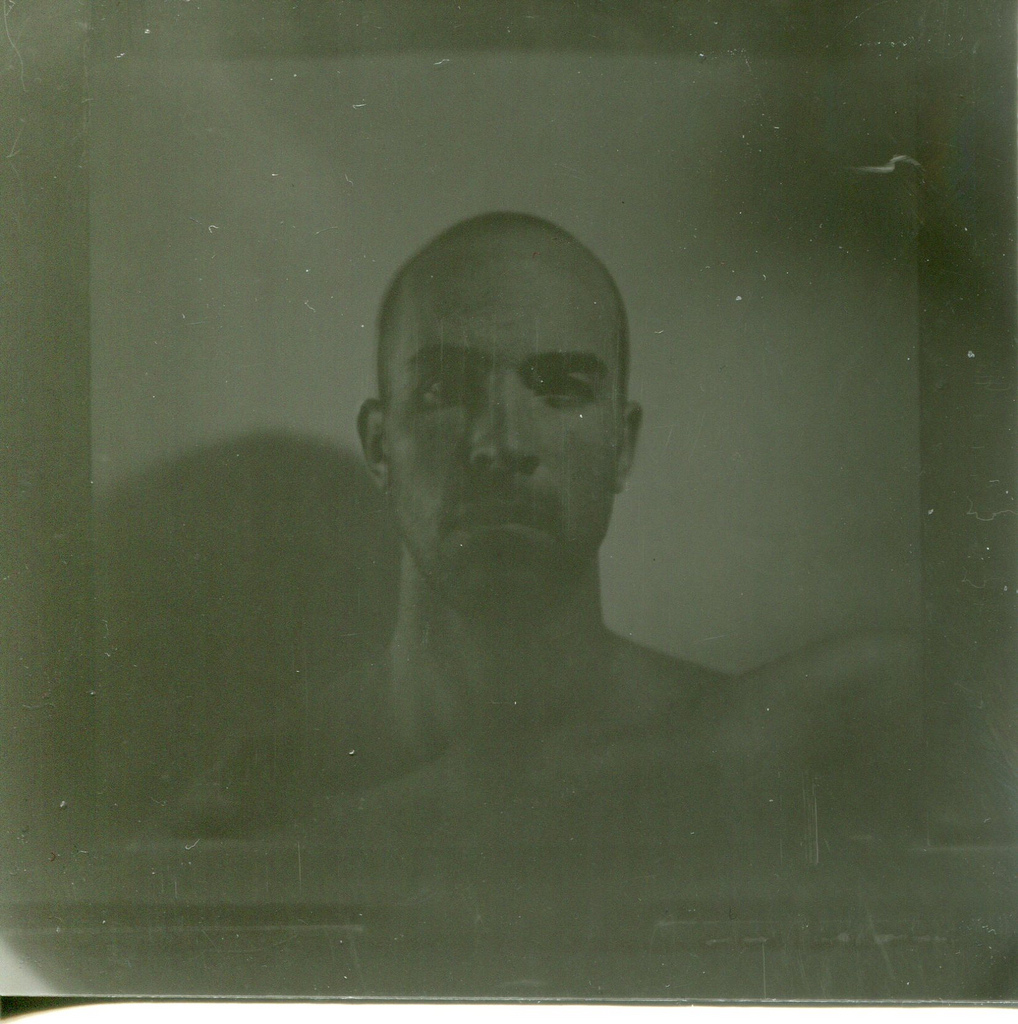

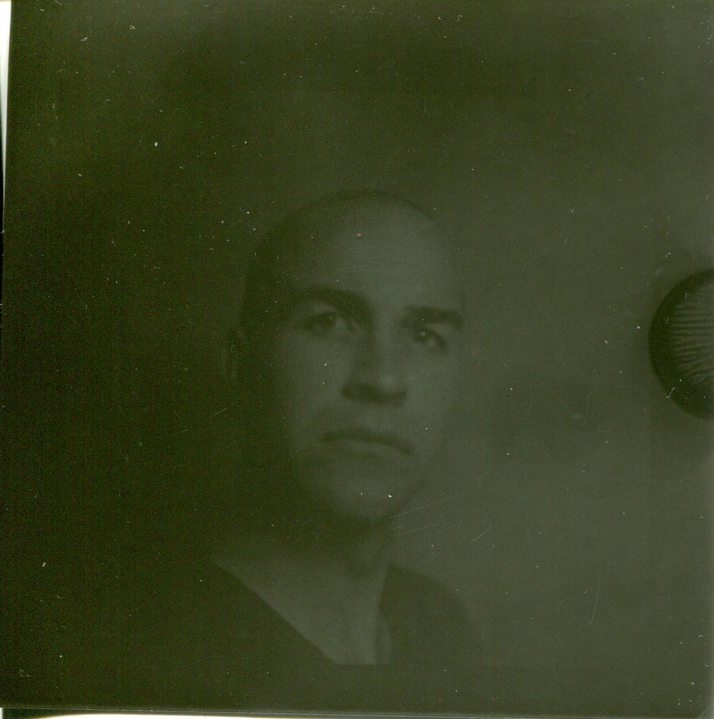

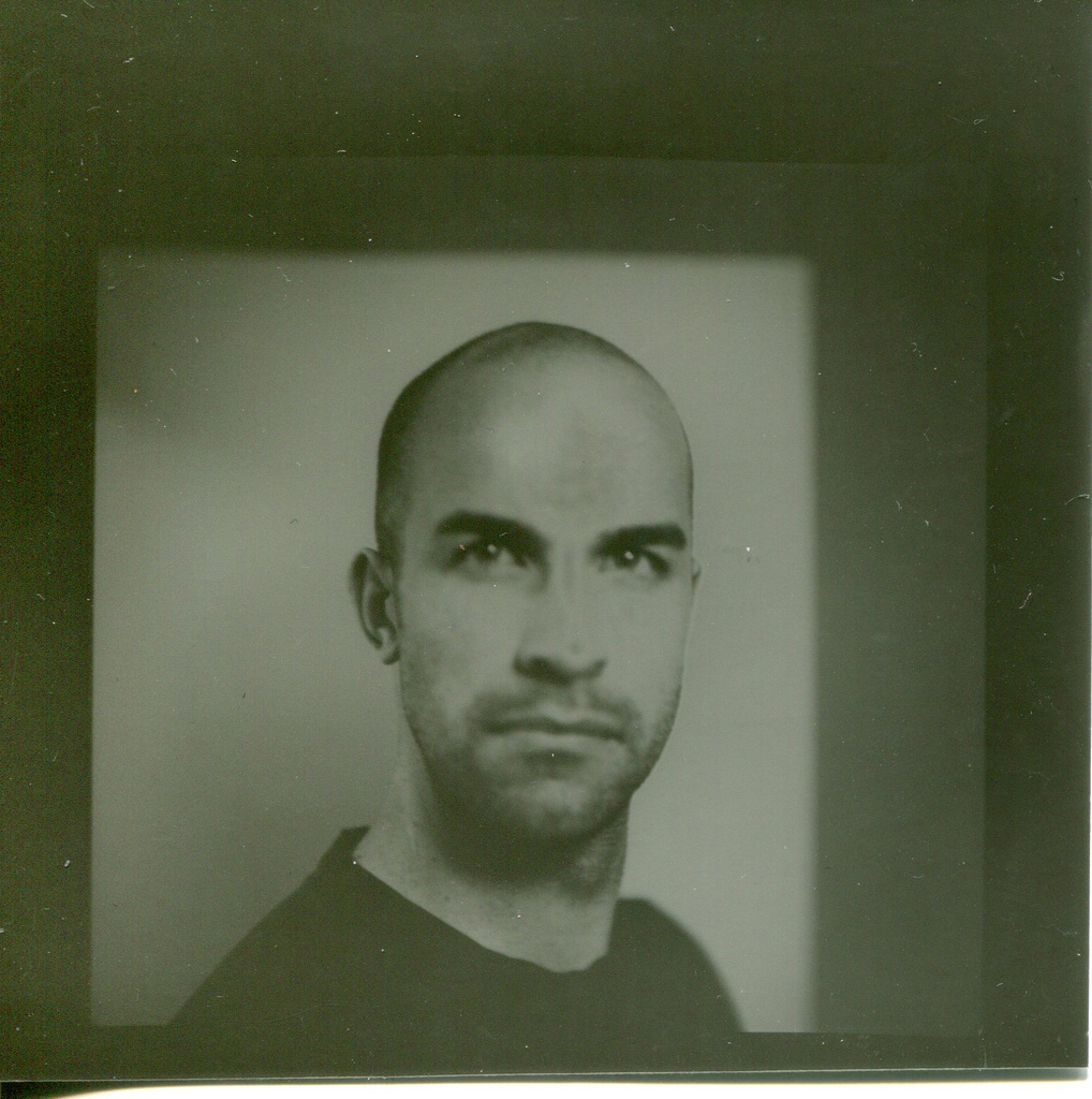

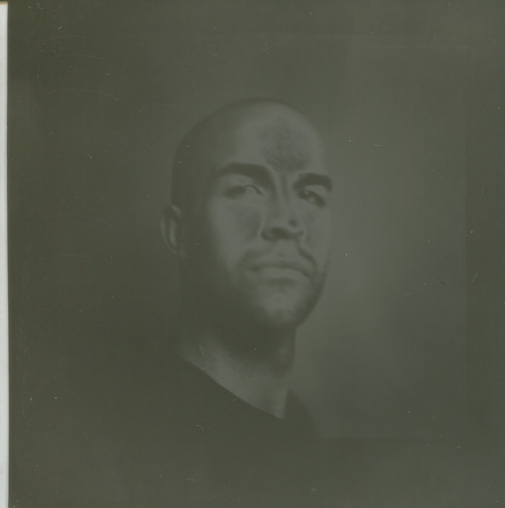

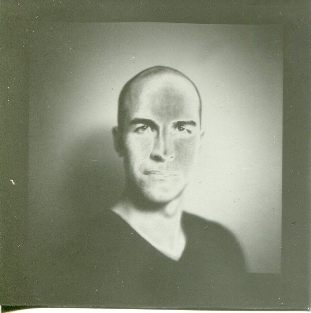

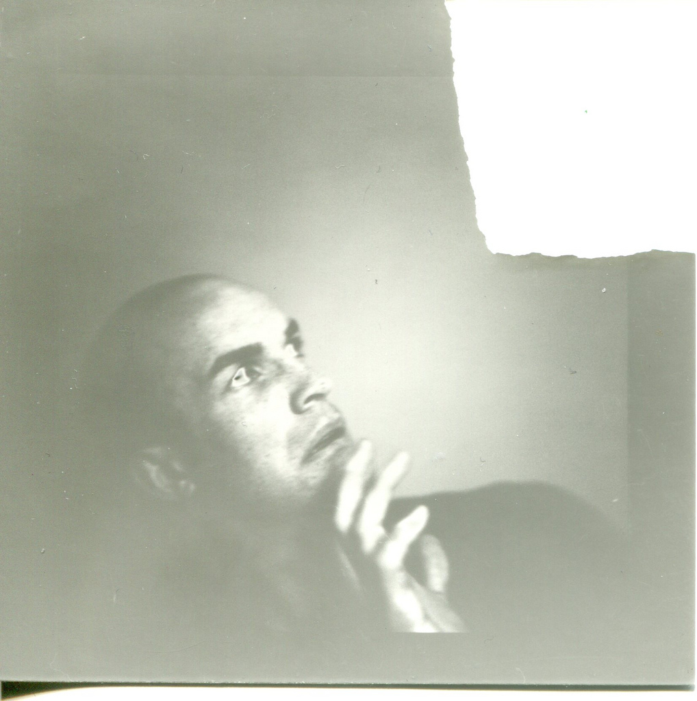

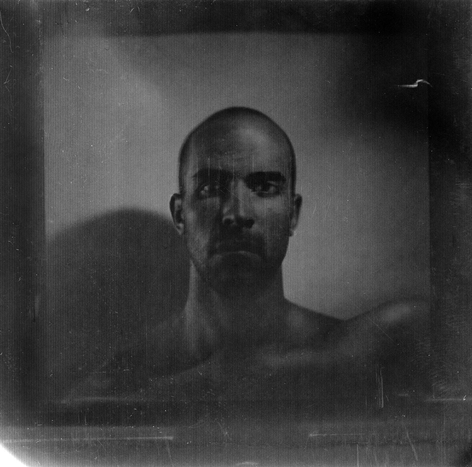

here're some scans of the photographs I made yesterday, all calibrated to maximize the scanner's range and replicate the relative tonal characteristics of each image. i scanned in color because there are slight hue differences with different exposure levels. i have not manipulated these images at all to make them comparable, but the actual photos have a characteristic gray-brown hue to them, rather than the blue or green color these scans show.
first, a little more technical information about the procedure. i placed myself in the focal plane, which i established with a no. 2 diopter and racking the bellows in all the way at wide open (Sekor 80mm f 2.8 blue dot). camera is loaded with lightly flashed paper, lights on, expose, lights off, develop to completion (1 min), flash for reversal, develop to completion (+water bath soak to a stop), fix, lights on and figure out what to do for the next one. as above, i metered the bathroom light at EV 3.5 for EI 12 and eye-balled exposure from there.
the first image was an overall failure. the following (second) plate was made with a 5s exposure with the flash. reversal exposure was roughly 0.2s. obviously blown highlights on my nose and forehead retained their density in the reversal process, and average density was high with a low contrast.
this next plate was exposed for about 3.5s with the flash and the door open (with light from my room lights and outside through the window). the reversing flash was a touch longer, about 0.25s. nice high density on the frame edge, and shadows, less held-over black blown out highlights, although the overall contrast is ridiculous and detail is only on my ear and neck where the exposure was lower.
this plate had an exposure of 3s with the door closed, and the flash. the reversing exposure was about 0.25s. better detail, no blown highlights, but again low contrast and higher average density.
this plate had an exposure of 6s, without the flash (didn't fire the first time so did a double exposure). reversing exposure was much shorter, about 0.1s. terrible blowing of highlights again. however, i was encouraged by the very high overall contrast generated by the short reversing exposure.
this plate was essentially all bulb, ~1.5s exposure. reversing exposure was at first 0.1s, but i saw the negative showed no perceptible density after a full minute of development. after a few seconds of development in the dark and not seeing any color change i flashed again for 0.1s, and developed for a full minute and let it rest in the water bath hoping something would come out. great tonal range, detail, lower average density, better overall contrast. this is my favourite photo, basically an accident (but a happy one).
this plate was ~2s exposure with flash, and a 0.1s reversing exposure (maybe shorter). i trusted that the nearly-zero observed negative density would produce a positive image, and produced a high contrast, low maximum density image. there is a black mark in my left eye (remember, rotated inverse images) from a blown unreversed highlight. as a side note, i'd ripped the corner off to test my developer that had been sitting in the tray at the start of the day to see if it was good having been mixed a couple days before (it wasn't, so i started this series of photos with fresh).
this was my most successful image from my first experiements with this approach, and was produced essentially by accident. scanned with the same scanner, same settings, for comparison. exposure for this image was with my flash (bare) held at arm's length, shot twice, ~20s exposure in lower incident light only through my bedroom window. reversing exposure roughly 0.2 seconds (i'm guessing, this was a month ago).
so it seems to me that there is a LOT of leeway for producing a recognizable photograph, but definitely needs dialing in to get good repeatable results. flatter, even lighting seems to have the ability to produce good detail and appealing contrast. from my experiments it seems that the strength of the latent image is less important than the duration of the reversing exposure--longer secondary exposure can compound with long initial exposures and solarize the crap out of your image. good, healthy developer seems to help the process along to generate good positive density, but definitely hurts tonality with fogged highlights and lower contrast.
