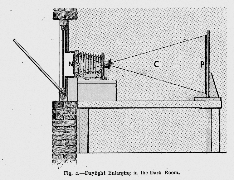

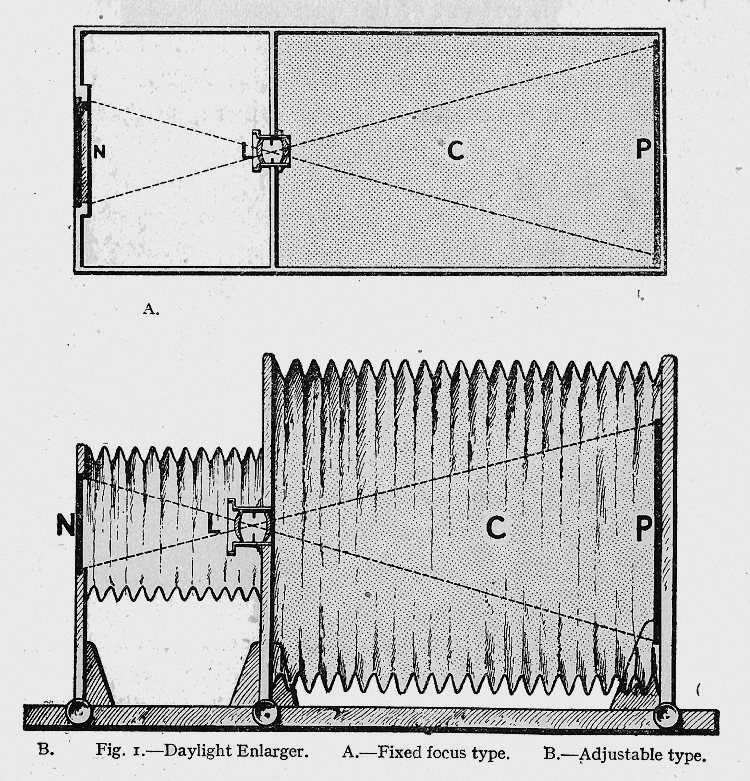

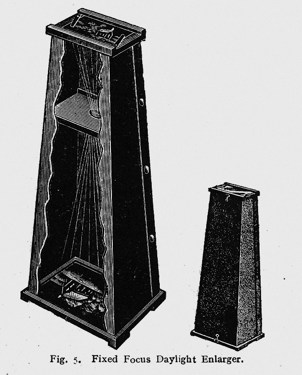

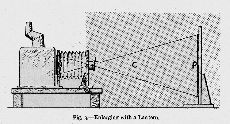

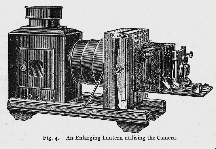

These illustrations are from the 3rd Edition Revised of "Photographic Enlarging" by R. Child Bayley, published around 1905, I have an original copy, I see there's a recent facsimile reprint. as you'll see enlargers where quite crude at this point:
Other publications like a similar age Ilford Manual of Photography have similar images, and there aren't many enlargers in the BJP Almanacs of the late 1890s but there's quite a lot by 1910. However there's still not much in terms of paper grades just a slow and rapid on certain papers, and it was still the same in the mid 1920's although by then some companies produced Soft, Normal, and Contrast paper grades of Bromide paper.
