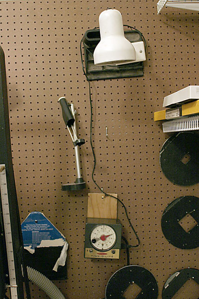

I have a Timeolite hanging on the wall attached to a small desk lamp with a dimmer on it. After calibrating I just lay the sheet on the table under the lamp and flash it before putting the paper on the easel. The lamp is about three feet above the table.
